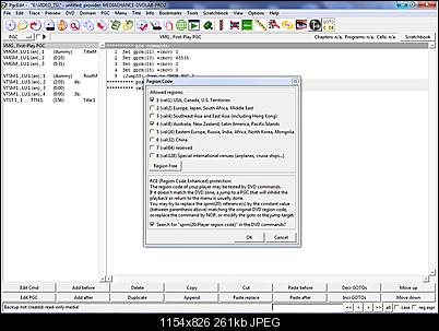

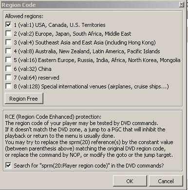

  4. Alternatively:
    Open the DVD in PGCEdit. Go DVD->Region Code and set it any way you like. OK and Save and burn to disc.

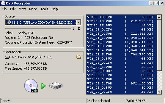

  7. Originally Posted by kirous View Post
    OK thanks. A question, as I see if there has been a change ?. Since in POPWER DVD sometimes I do not see the type of region it is. No other player that I can see ?
    My own opinion is that it's silly to set your home-made DVDs to a particular region, but do as you wish. Are you asking how to see what the region is? If so, open the DVD in DVDDecrypter and it'll tell you.

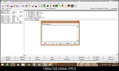

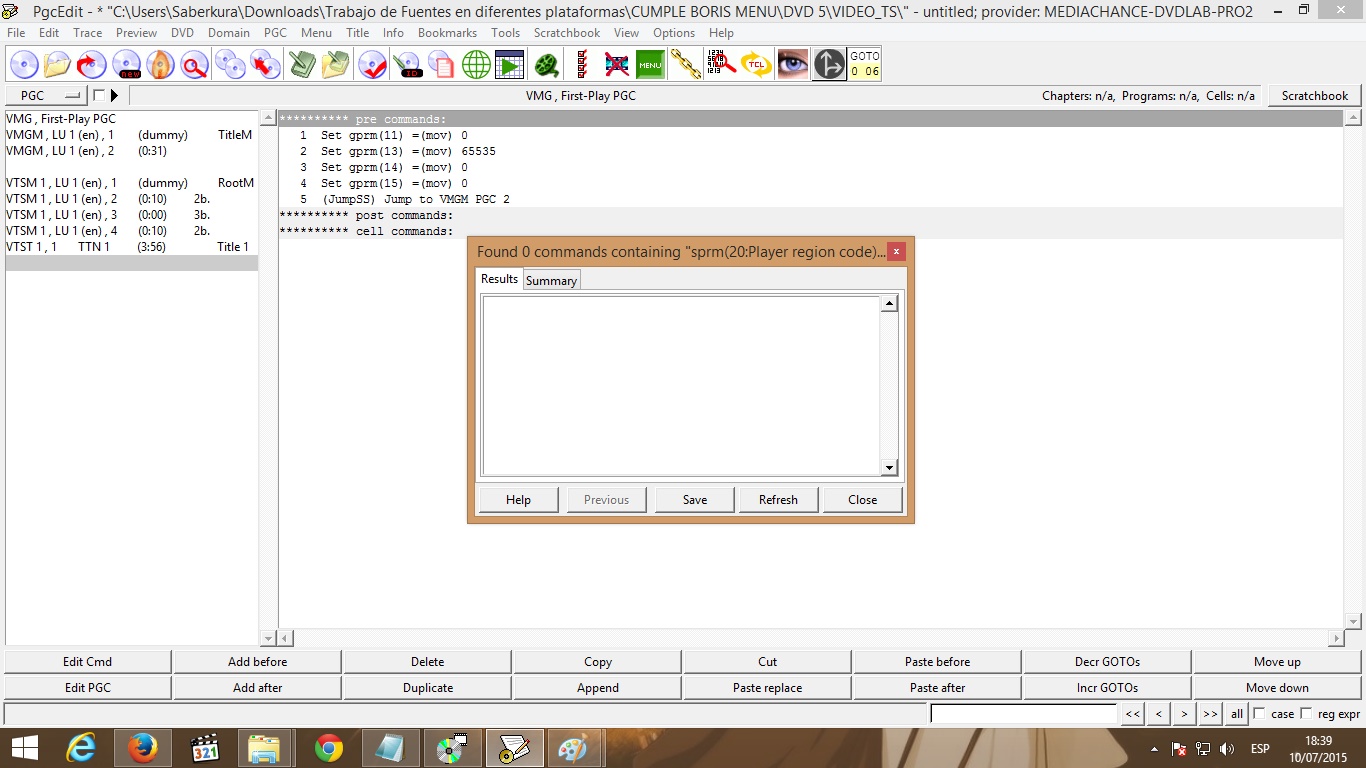

    Upon clicking "OK" in the window "Region Code" of PgcEdit program, I get this message:
    In that message is? that I have to do there ?.
    Once again.... Sorry my bad englishXD!!
  11. Originally Posted by kirous View Post
    You have to do nothing. Hit 'Close' and save your work and you've changed your DVD to Region 1 (or whatever region you wanted).
    That box was just to see if any other changes had to be made to the DVD besides just changing the region. And nothing else had to be done, which is why the box was empty.
    Once the DVD is saved and you want to make sure you changed the region, open the DVD again and go DVD->Region Code and it'll show you.

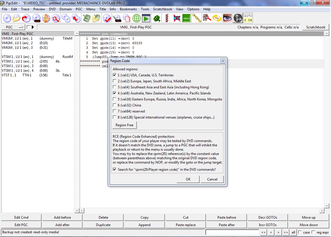

    I auditioned, what you me you said, I did everything, but there is a problem.
    Would be that the program PCGEdit loading the DVD and see the region is this all OK, as the following image sees:

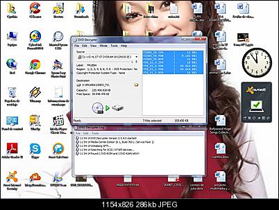

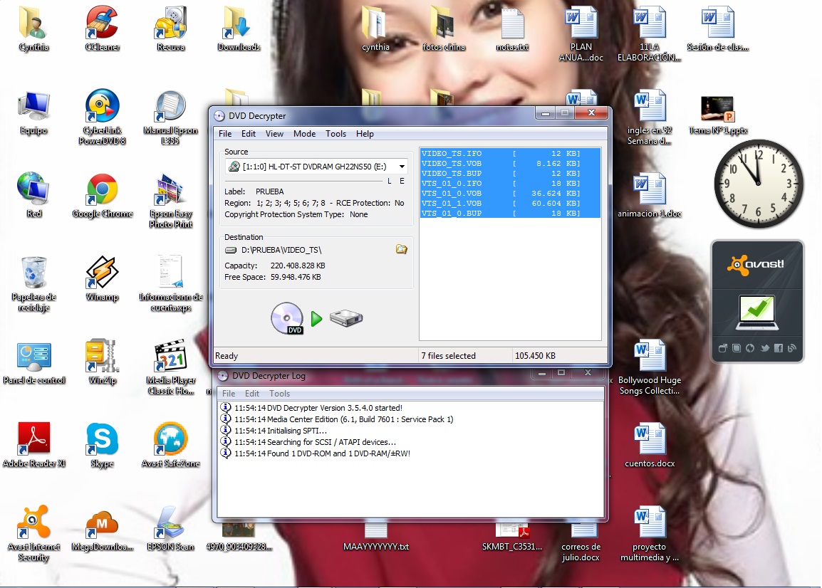

    But when you open the DVD Decrypter and load the disc, I get this, as the picture looks:
    The question is: Why do not I changed the region is displayed and this viewing me as a free region?. That's all done in the PgcEdit?
  13. After spending way too much time testing what you said, I decided you were right. After making the changes in PGCEdit, DVD Decrypter still shows it to be all-region. I don't know if DVD Decrypter is wrong or not, as I don't know of other programs that give the region. Maybe PGCEdit doesn't change something else that should be changed to make it possible to assign a region.
    Maybe someone else knows of another way to check the region. Sorry for not being much help.

  19. PgcEdit sets the region code correctly. I think that DVD Decrypter displays the region code of the DVD as it will be if you rip it. Since by default it makes it region free, it displays no region. And BTW, it should display a warning if the region is NOT set in the original DVD. If you can't see the warning, that means that the region code has been set, even if it is not displayed in the main window. Anyway, the simplest way to verify if it has been correctly set is to close PgcEdit (just to be sure), then restart it and reload the DVD. Then see DVD -> Region Code, and it should display the region that has been set previously.
    r0lZ - PgcEdit homepage Hosted by VideoHelp (Thanks Baldrick)
    - BD3D2MK3D A tool to convert 3D BD to 3D SBS/T&B/FS MKV
  20. Originally Posted by r0lZ View Post
    That can't be right as I just checked an R2 DVD I had nearby and it showed it as being R2. But it's good to know that PGCEdit does set a region correctly. Thanks for weighing in.
