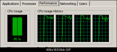

    I've experimented a bit with MP_Pipeline lately. It tends to speed things up a bit, probably because of the memory limit for a single 32 bit process. Although with MP_Pipeline I can usually only run one encode at a time due to the extra memory usage or it all goes to crap (I'm still running XP). I posted some initial results a while back, but it might be worth playing with even if you're using MT Avisynth.
    This is single threaded Avisynth, running a single encode, re-encoding a 1280x720 video with the following script.
    MP_Pipeline("""
    LoadPlugin("C:\Program Files\MeGUI\tools\lsmash\LSMASHSource.dll")
    LWLibavVideoSource("D:\video.lwi")
    QTGMC(InputType=1, Preset="medium", EzDenoise=1.5)
    ### prefetch: 16, 0
    crop(8, 4, -6, -4)
    Spline36Resize(1280,720)
    LSFMod(Strength=75)
    gradfun3()
    I'm still having a bizarre issue with the latest QTGMC and LSFMod in the same script. I run QTGMC in progressive mode for noise filtering quite a bit. Originally if I started encoding from the beginning it'd run at half the speed that it would when using Trim() to start encoding from not quite the beginning. MP_Pipeling seemed to fix it in that case, but the video I'm encoding at the moment (not the sample I posted in this thread) has exactly the opposite problem. If I start encoding from the beginning it runs at twice the speed it does if I use Trim() to not encode from the beginning, and even MP_Pipeline isn't helping.
    It's only a problem with QTGMC 3.33d or 3.33s (the latest version from the doom9 QTGMC thread). QTGMC 3.33 or earlier are fine. Computers....
  10. Wow, I am surprised you get 95% CPU usage from a single threaded version of QTGMC. I am not sure why my PC is different but I can never come even close to that in ST mode, more like 25% to 30%. My PC isn't exactly new either. It is an i7-3770K from 2012 so three years old. But like you, I am eager to rebuild when Skylake arrives. Although I am really hoping for a Skylake-E with 12 physical cores cuz I want my next machine to be 4K ready.
