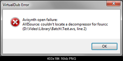

  8. Here is the error code when I try to use AVISource which is Line 2:
    FWIW, here is the Mediainfo. So I am not exactly sure what it is complaining about. It doesn't like the dvsd fourcc?
    General

  10. You can use cedocida for a VFW DV codec
    DV-AVI is very stable and consistent in premiere, and all editors - it's unlikely something is actually wrong
