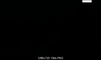

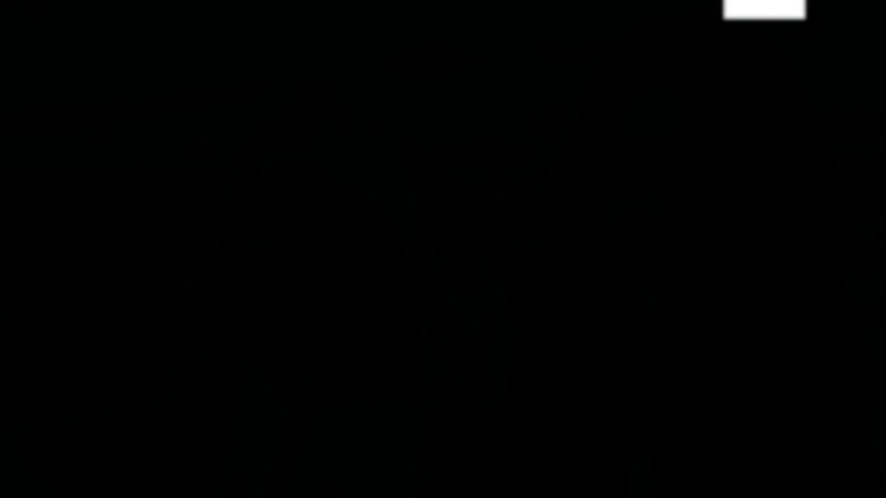

  20. You use an "alpha mask" to blend areas of 2 different videos together.
    Where the image is white pixels come from the first video, where the image is black pixels come from the second video. Shades of grey in between are a weighted blend of the two.
    amask = ImageSource("amask.png").ConvertToYV12(matrix="PC.601")
    source = ffvideosource("videoB_encoded.mp4")
    patch = source.ReplaceFramesMC(4653,14)
    Overlay(source, patch, mask=amask)
    In this script the image is loaded and called amask. The source video loaded and a copy of it is made (patch) with the problematic frames motion interploted with ReplaceFramesMC. Then Overlay is used to merge frames of the two videos.
    Attached is a short video that shows a bit of the original video with the glitch, followed by the same segment after the fix. My mask wasn't quite perfect -- if you look closely you'll see a little of the green blotch still shows up in a few frames.
