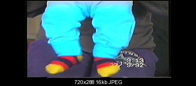

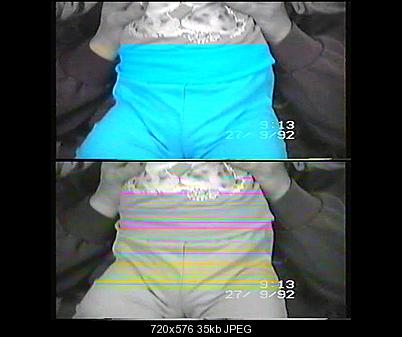

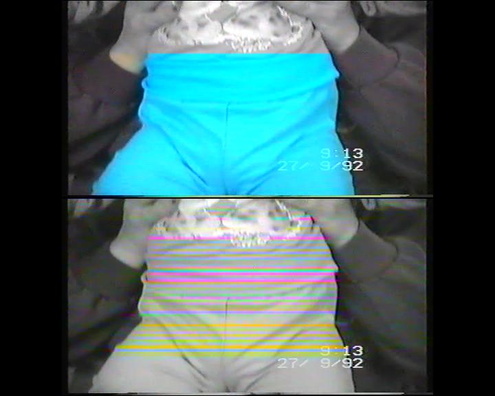

  26. The colors of the bottom field are very messed up. The colors in the top field are clean except for flickering at the top. Here I've separated the two fields and stacked them rather than weaving them:
    One way to address this is to throw away the bottom fields and resize the top fields:
    SeparateFields()
    SelectEven() # keep the even fields
    Spline36Resize(width, height*2) # resize back to full height
    But that will leave you with less smooth motion and some aliasing artifacts. A better method is to apply the colors of the top field to the bottom field. But the bottom field colors will be displaced when there is motion. Note how the colors don't line up on the baby's feet:

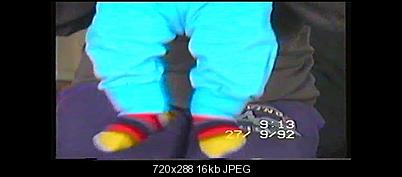

    A way around that is to motion interplate colors from the top field, then apply those colors to the bottom field:

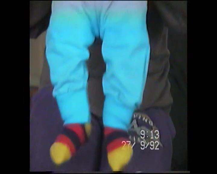

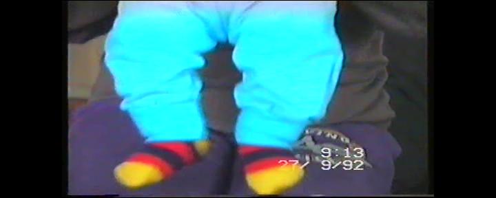

    The colors are over saturated so they need to be toned down. I decreased the saturation and brightness to get them mostly legal without washing them out. I also sharpened the chroma channels and shifted them to better register better with the luma.
    Mpeg2Source("2.d2v", CPU2="xxxxxx", Info=3)
    SeparateFields()
    evn = SelectEven()
    odd = SelectOdd()
    chr = evn.DoubleFPS2().SelectOdd() # generate motion interplated colors from the even field
    odd = MergeChroma(odd, chr) # and apply them to the odd field
    # put the even and odd fields back into interlaced frames
    Interleave(evn,odd)
    Weave()
    ColorYUV(gain_y=-40, off_y=-4, cont_u=-100, cont_v=-100, opt="coring") # tone down saturation, brightness
    QTGMC(preset="fast") # smart bob for progressive MKV
    MergeChroma(last, aWarpSharp(depth=30)) # sharpen colors
    ChromaShift(c=-2, l=-2) # shift colors 2 left, 2 up
    You might also stabilize the colors with a temporal filter. But I don't see an easy way to fix the flickering, and lack of, colors at the (mostly) top of the frame. And I haven't addressed other issues like the aspect ratio.

  28. OK.Thanks again for your effort.Downloaded AviSynth and will try to investigate how that software works.
    Your result is simply Amazing.I understand that not Always there will be such result but that improves video quality significantly.
    How about programming/scripts? Is it any ready to use somewhere on the net or each one needs to learn it slowly?
    Will loook at guides but this scripting is totally new stuff for me.
    Once again big thank for all your help guys!
