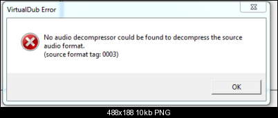

    Still the same. It wont work. If added the file to the video and want to convert it to mp3 in virtualdub.
    Please help. THX

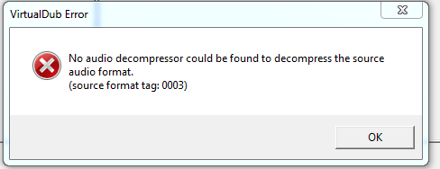

  4. Originally Posted by volker028 View Post
    [Attachment 32405 - Click to enlarge]
    Please help. THX
    Don't be confused with multiple ACM codecs in system - some of them decode MP3 - select Lame ACM.
