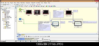

    Hello everyone, rather if I can help create a PLAY SUMMARY like a movie without the need and use the Summary button next DVD LAB PRO
    Here my DVD structure

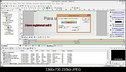

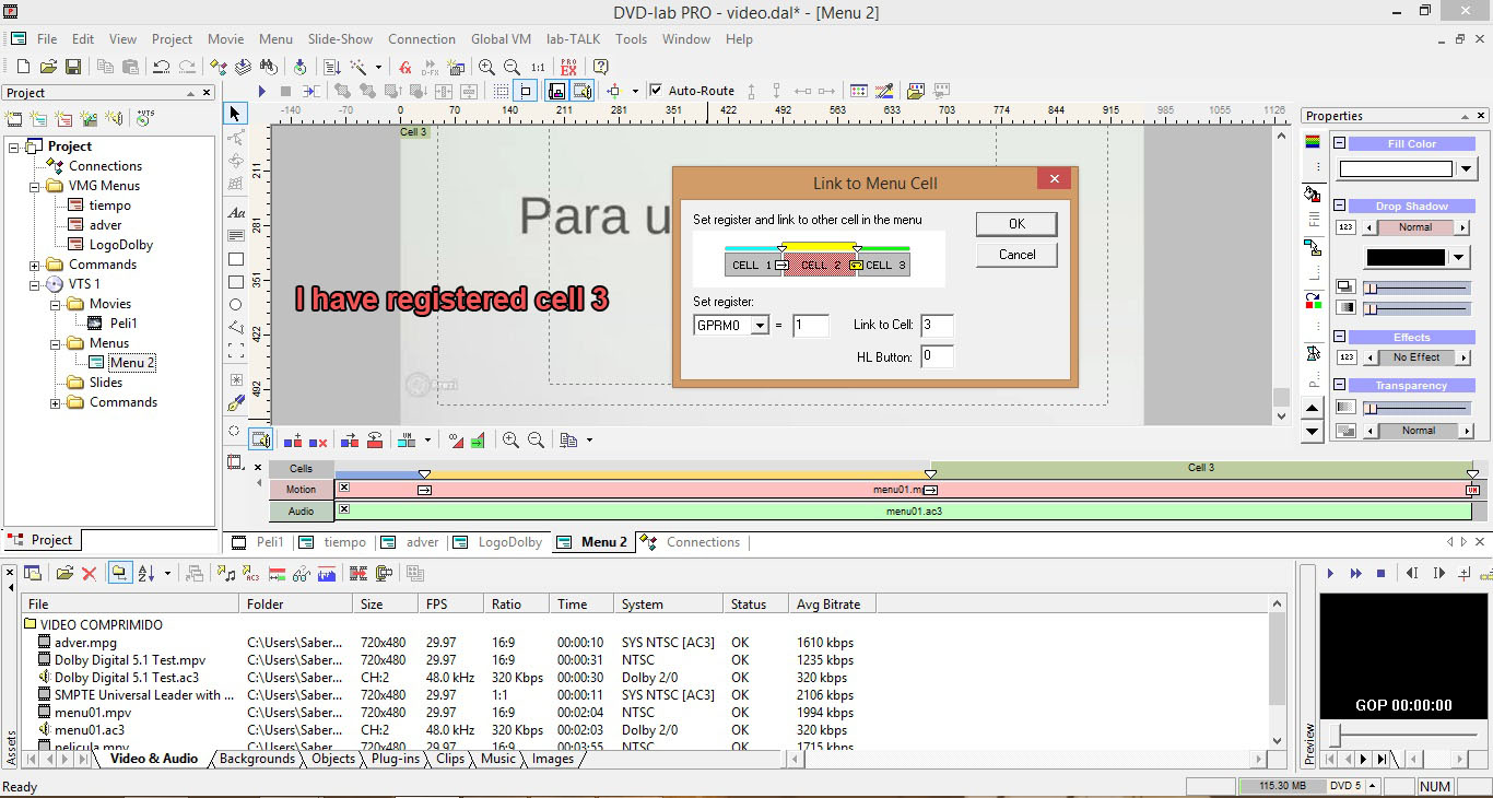

    In the Main Menu you have 3 cells and the third cell is registered as GPRM0 = 1, as the following image shows:
    Hopefully you can help me and tell me how it's done as a guide. Sorry my bad English XD

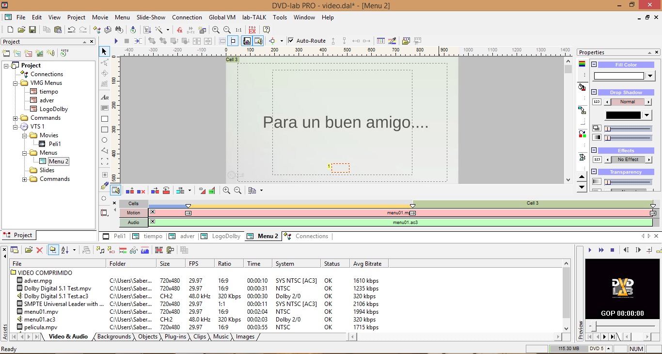

    OK, to be more clear.
    When the movie starts, entering the PLAY button, the movie incia and continues its course of reproduction ..... everything OK here.
    But if you want change, whether DUAL audio or subtitles, you enter the main menu and then choose any of the options mentioned, and once done, you go back in the movie, but the movie should be where you leave and not have to start again. .. me you get the idea.
    So the main menu I'm working with cells as it is a menu with animation and how to program using the VMCOMMAND, so the cell three of them have registered as GPRM0 = 1
    So I want the PLAY button is much like the beginning of the movie and abstract at the same time as the original DVD's.
    So I need you to guide me or make an explanation of how to do it with the VM COMMAND, seeing the structure of the first image.
    All that's it, the only problem is that.
    No clear if everything you said ..... I'm bad at English ..... but that's the idea.

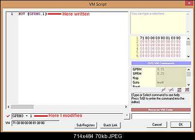

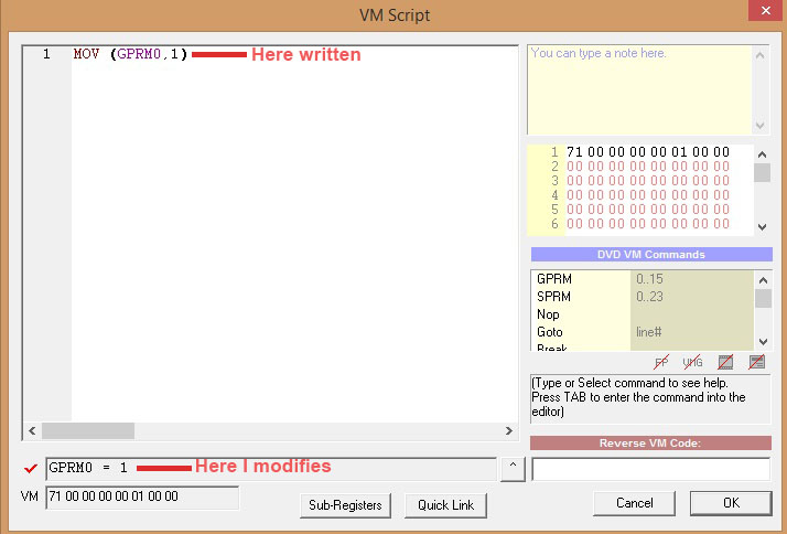

    what happens is that the command you give me an example does not work, except that if GPRM is maintained and does not change to another command, in other words not changed.
    The trouble is that I do not specify if the VTS or MOVIE to put that syntax.

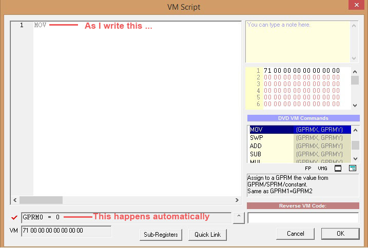

    Rather, the "MOV" command does not remain such as you are mentioning, writing appears as disabled and if I put a GPMR, the re-named as GPMR0 more value.
    Already tried so many (searching the internet too), since the right would come to be this:
    MOV (GPRM0,1)
    but changes to:
    GPRM0 = 1
    For a sample in the following images:

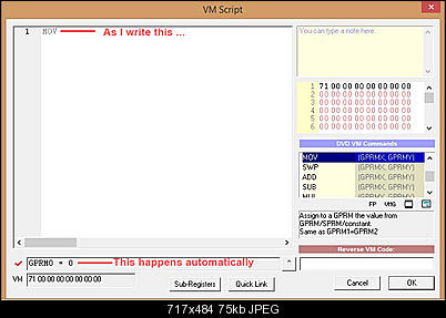

    Here the "MOV" command reads it as disabled:
    All of these images, that solution can be drawn?
    Look, for you know it, in the following images of my project, really like the GPMR registered and that I am using for the button function menu and title in the specified cell:

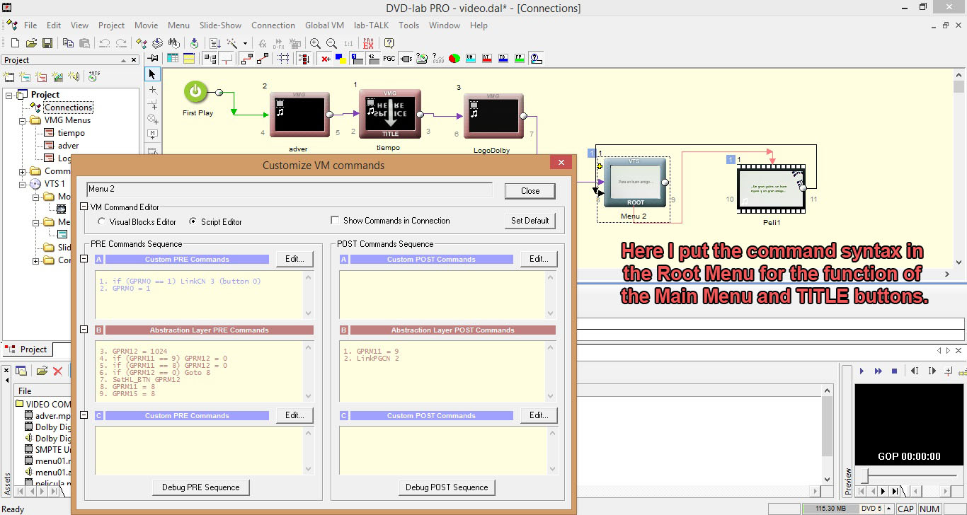

    What I have seen in some post if it is programming on the same MOVIE, both PRE and POST COMMAND, but even so the result is not satisfactory, errors arise, and even tried some and fails.
    Well, someone who knows or is advanced level help me in that little problem.

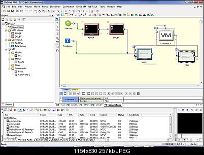

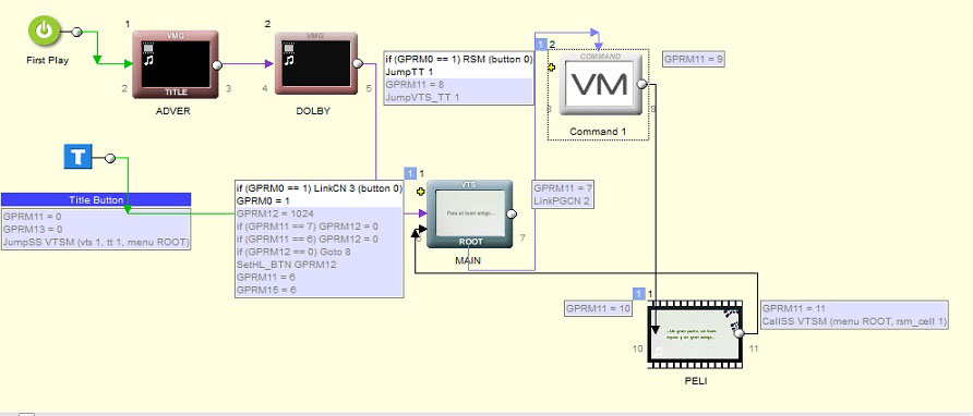

    With that syntax, I have placed a VMCOMAND, giving the output of the second point I'm asking where the image is displayed:

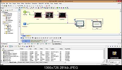

    Here with coding:

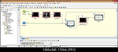

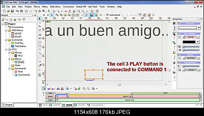

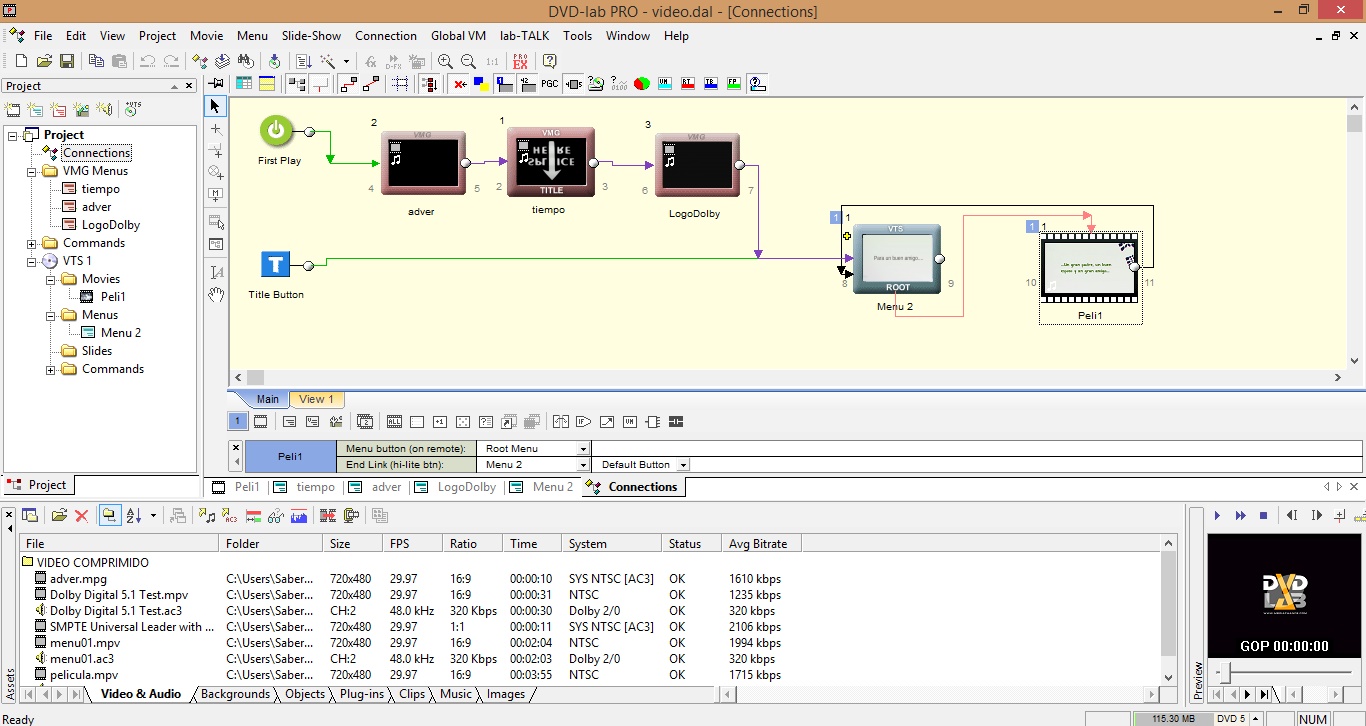

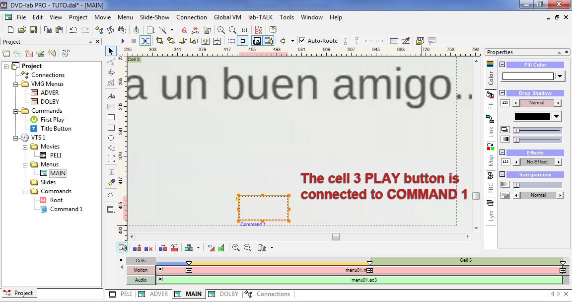

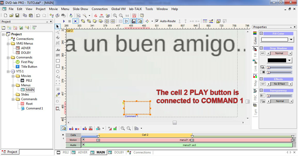

    And this is where I connect the play button with COMMAND 1, both for cell 2 and 3:
    With that, I do not know if what I'm doing wrong, or whether it will be well placed, but in the end, nothing happens, it hangs on any media player.
    I on my part use Media Player Classic Home Cinema and Power DVD 8, to see the result.
    Well, with this, you will understand a little structure.
    If you put that syntax, without using the cells it would be different.
    But this would come to be like a professional player.
    And watch, I'm using DVD LAB PRO, the syntax that you mention is for sony Arquitech, but I think that's it.
    It would be good to answer my questions, show me pictures of how it should be.
  11. I used syntax from PGCEdit, I mentioned that, you can use whatever correct syntax there should be used within DVDLab Pro. I found that very cumbersome to write codes in DVDLABPro. So I just create whatever there must be created or it is easy, and then I fill it in in PGCEDit. PGCEdit write correct syntax for codes for you, you do not have to remember those exact codes, you just fill out their wizard on screen for any possible command. To try to write codes in DVDLAB directly is very difficult and cumbersome and you suppose to know those command in the first place. Very unintuitive. PGCEdit is THE tool for that.
    YOU have to set GPRM0 to 1 in pre-command section for title (movie). So that flag 1 would indicate that title (title means movie, title menu is different thing) was already played.
    And that code (but correct in DVDLabPro syntax, not this one, this is PGCEDIT syntax :
    if ( gprm(0) == 1 ) then { RSM }
    (JumpTT) Jump to Title 1
    is to be executed after pressing PLAY button in the menu. How you going to do that, it is up to you. You might create extra PGC for that so PLAY button just jumps into that PGC where you put that code. Or there is possibly many other ways to do it.

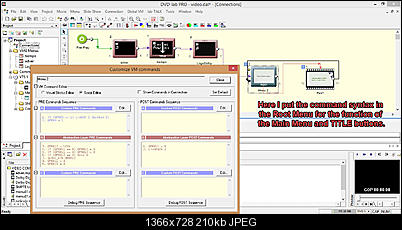

    MMMMM, so if you can say is that this program will not use, I am a newbie, but something you said and that is disturbing me, it's about creating a dummy PGC in the VMGM, by which it was made.

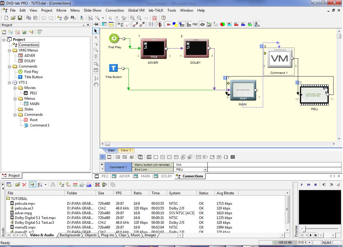

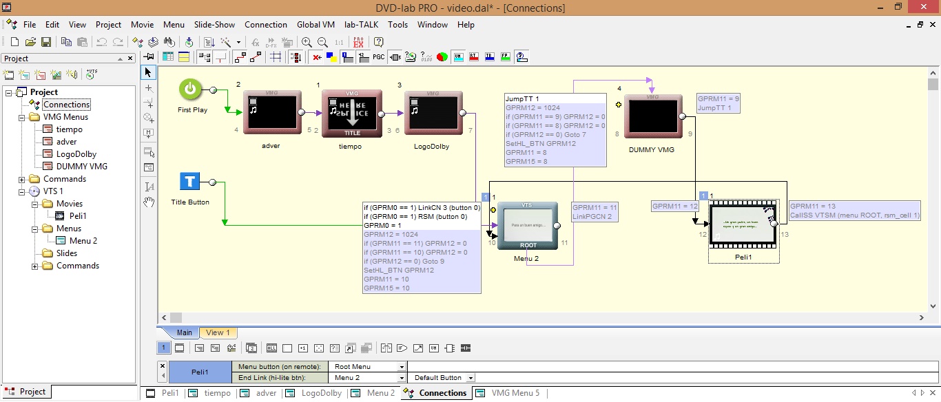

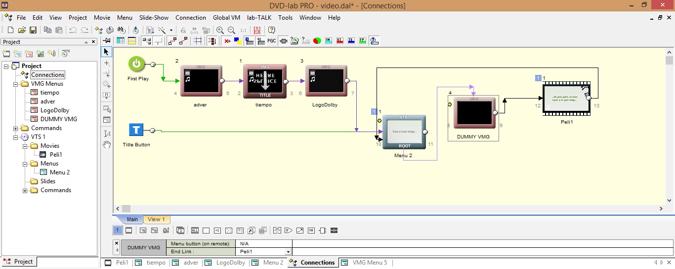

    Here the picture:
    Here the code:
    Look, the PLAY button cell 2 and 3 are connected to the VMG.
    Yes is not well done, but even with this form does not make me a summary MOVIE, but if reproduction is no longer hangs.
    But if you put the:
    In the dummy VMG, It hangs.
    Rather, image codes, which should be added, or carry anywhere, or Remove to say.

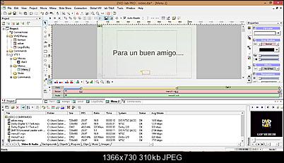

  13. You use GPRM0 for two different purposes.
    If GPRM0 is already used as a memory that controls to what cell you need to jump in the menu, then for that resume control choose another empty memory you have there, for example GPRM5.
    You can create empty PGC/menu in VTS domain, instead of that VMG for this purpose, it is more logical, so that tutorial below creates that dummy menu/PGC in VTS, not VMG.
    It is really simple, but those navigation things are difficult to explain.
    To do it most simple way, in DVD Lab Pro:
    1. create extra VTS menu, in the same VTS you have that title and menu, in your case VTS 1,
    2. set link for your play button in your menu to that new created VTS menu/pgc
    3. export VIDEO_TS in DVDLABPro, it will protest that there is no link set for that new VTS PGC or something but that is ok, you fix it in PGCEDIT
    then load PGCEdit, open that VIDEO_TS:
    1. and just close all windows that pop up (you do not need to check what it offers you)
    2. on the left find your main movie (title), click on it, and on the right find last pre-command line , right click it and choose "add after"
    3. double click that new created line that says "nop" and choose "alphabetically"then "Set" and then set GPRM5, value 1 ,OK
    you should create this command:
    Set gprm(5) =(mov) 1
    4. find all other titles on your DVD on the left , do the same except value would be 0, to get this command:
    Set gprm(5) =(mov) 0
    5. find that new created VTS dummy menu on the left and again add two lines there at the end, so first add a empty line on the right again, then for the first line choose "alphabetically", RSM, check if, GPRM5 and value 1, OK, that will set your command to:
    if ( gprm(5) == 1 ) then { RSM }
    second line would be "Jump and Call", "From VTS title" , "to VTST title in the same VTS" , "Jump VTS_TT" and make sure title number is the same, 1, so that second created command here would be:
    (JumpVTS_TT) Jump to TTN 1 in this VTS
    6. Choose File/ Save DVD
    I'm sure that you can use DVD LAB Pro only, not PGCEdit, perhaps it would be very easy, I just know PGCEDit and use it that way, it is much more efficient and comfortable but I understand that first time using PGCEdit might be overwhelming also ... just tackle this your way ....
