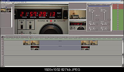

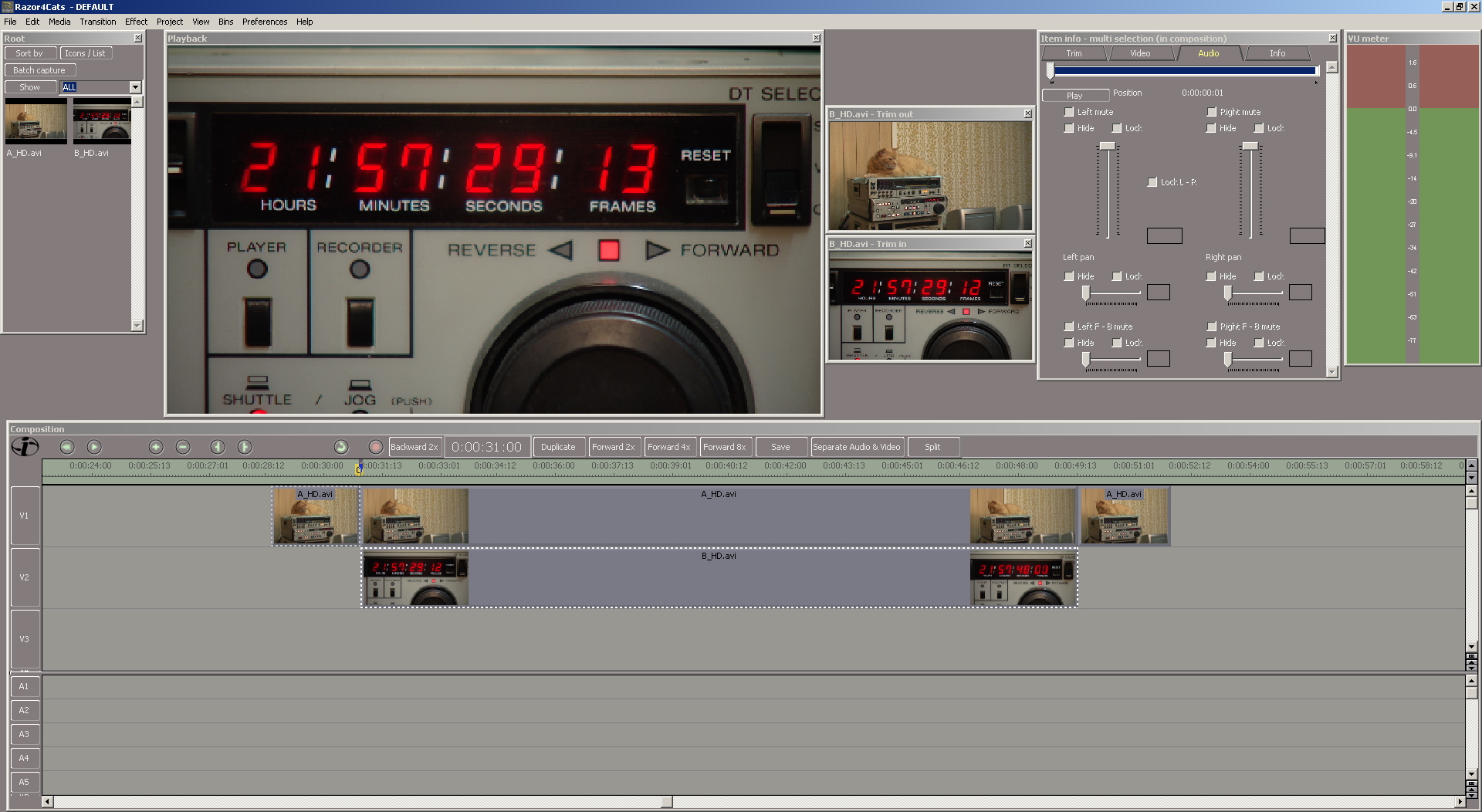

  7. I have upload A.MXF and B.MXF with a sincronous timecode (there are connected to the cameras a timecode generator, it's connected also to the betacam deck shown in the video. I personally check from above that the timecode was exactly sincronous to all)
    please download:
    https://www.dropbox.com/s/asjcilbo88nnlhs/A.MXF?dl=0
    https://www.dropbox.com/s/clfgx0kp6qidasy/B.MXF?dl=0
    so that this is the situation
    I try to understand if there is way to playback the common part of the 2 video files, in 2 windows, in this case the start and stop of the playback have to be the total lenght of the B.MXF

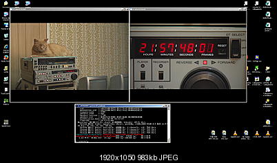

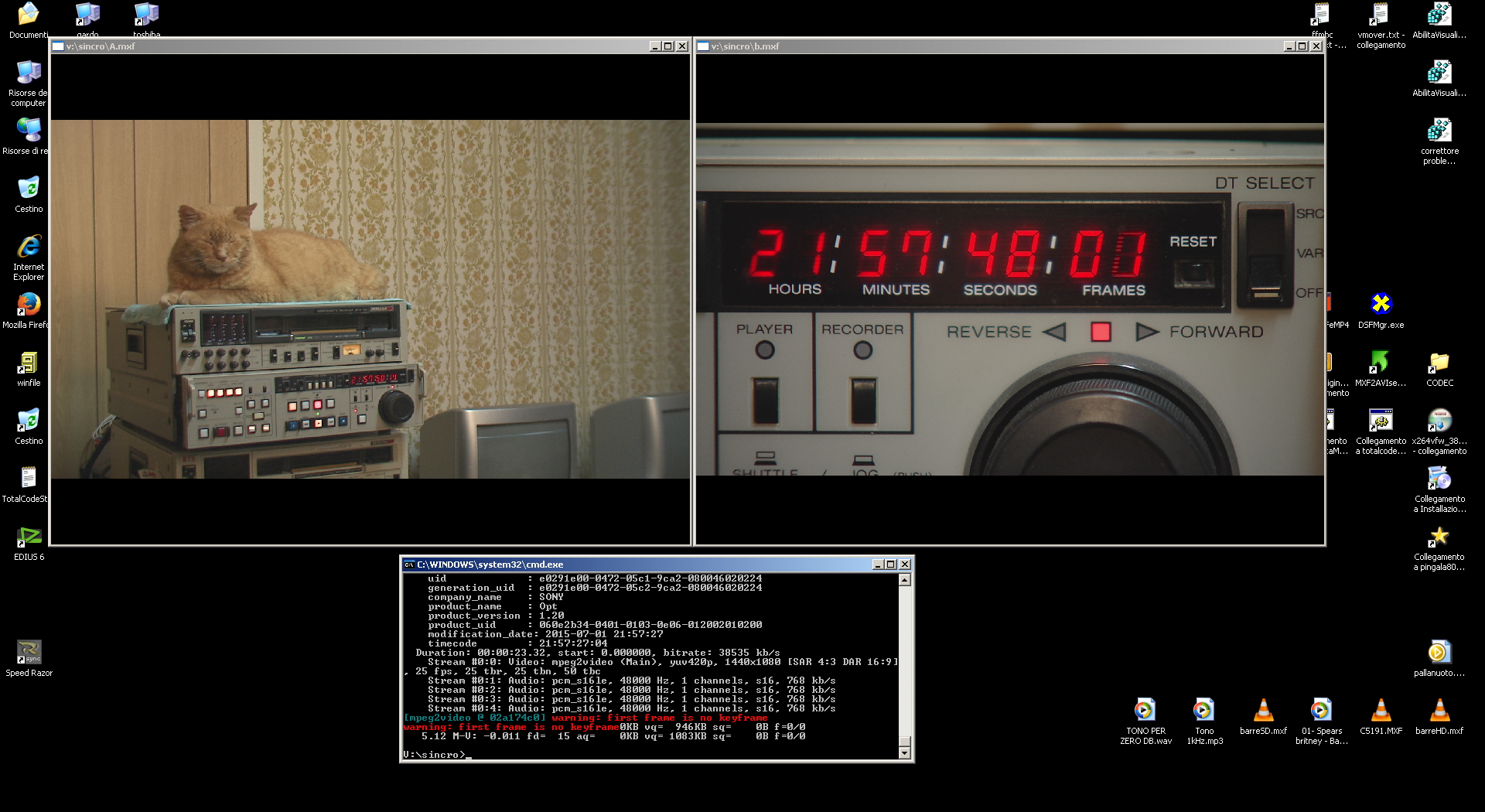

  10. it "works" but I need to make start the A.mxf from the timecode (starting) of B.mxf and put besides the 2 windows as this
