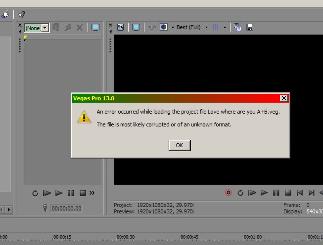

    My Sony Vegas Pro 13 doesn't open a file I worked on it yesterday!
    I work on a music video clip and yesterday (as always) I saved it and backup-ed it
    before closing down. Today it DOESN'T open !!!!!!! Not even the backup file and
    NOT even the "veg.bak" file !!! It says "Error opening... file corrupted or unknown"!!!
    I'm very anxious, as it's work from three weeks and I have no way to restore everything I did
    with image choices, combinations, transitions etc. Describing all in another file would become
    a whole book... so I'm really in a trouble.
    Could anyone give a suggestion? A picture of the message is attached.

Name:	SonyVegas ERROR msg.jpg

  4. Yes, as I said, it doesn't open ANY of the previously saved neither the .bak file.
    BUT !
    I re-started my computer in 'Safe mode' and tried to open my file from there and...
    it gave me a supplementary error message:
    "Error Unsupported OpenGL version!
    HitFilm plug-in requires OpenGL 2.0 or above and GLSL 1.2 or above.
    The current versions used are OpenGL 1.1 and GLSL 0.0"
    So that means I must find these updates. Any suggestions?

  13. Answering all your friendly suggestions.
    1. It becomes obvious that the problem is with the HitFilm plug-in, I suppose.
    2. Yes, I should mention that I run a "pirate" version I took from someone. I'm a musician not a video pro, I just sometimes do my own music video clips. So if the "pirate" is a problem, I should possibly buy the original software. But will the original open the file that the "pirate" takes as "corrupted/unknown"?
    3. As I have my file double-saved, I suppose it will not be influenced or damaged if I try to do/install whatever more things in the software Vegas Pro itself.
    4. Ok, I re-installed Vegas Pro but nop, it still doesn't want to open my file! But it still works fine with other files from projects I've worked before. So re-installing doesn't solve anything.
    I really need to find a solution, I can't let this file go lost !!...
