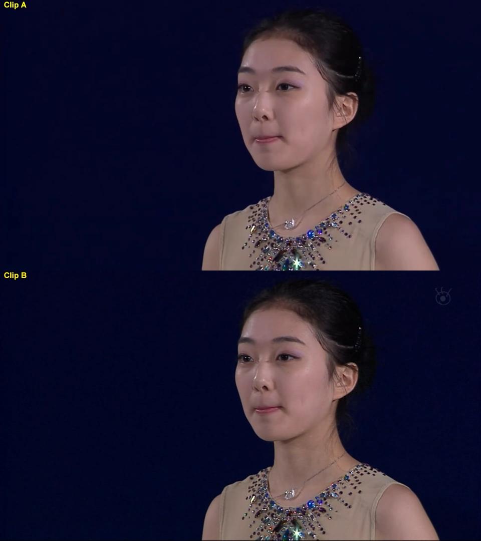

    I want to match the color of clip A with the color of clip B
    change the color of clip A so that it matches the color of clip B
    I use Color Match video fx plugin but it doesn't work !
    Anyone know how to match the color ?
    Here are the segments of the clips

    These clips have the same colors. Not to mention that are very dark.

  3. You can look at the face of the girl (not background)
    You will see the different
  4. You have mostly a rec.601 vs rec.709 problem. To make ClipA look like ClipB in AviSynth apply this to ClipA:
    ColorMatrix(mode="rec.601->rec.709")

  6. Originally Posted by jagabo View Post
    Yes, it is what I want .
    But I have no idea about AviSynth
    Would you please teach me how to match color by AviSynth ?

    Sony Vegas has a "Color Match" tool. It's simple.
    You adjust one piece of media to the colors you like, and you can paste that look wherever you want. You can save it as a preset too. That way you don't have to keep starting from scratch.

    There's probably no need for you to learn AviSynth. I don't use Vegas but surely it must have the ability to convert rec.601 colors to rec.709. Maybe under the source properties you can specify the color matrix.
