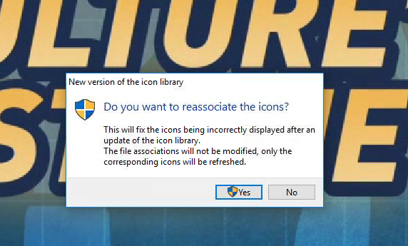

If I reset it to its default settings, after asking me if I want it to check periodically for updates, it then brings up a dialog box called New Version of the Icon Library, asking if I want to reassociate the icons. "This will fix the icons being incorrectly displayed after an update of the icon library. The file associations will not be modified, only the corresponding icons will be refreshed." Why am I getting this message every time I reset? I never used to. Is it normal? What's the point of it?

I have the same exact problem. media player classic was installed with k-lite codec pack like always. Running JAN 2016 release. We are just fresh installing this machine to windows 10. When every video plays, a popup which i have attached is displayed by windows. clicking yes or no has no effect, keeps popping up when the next video is played.
The user running MPC is an administrator and the windows install is brand new on brand new hardware core i7. It is not a machine problem. Just posting here incase anyone ever solved this. When i find a resolution i will post back.
[Attachment 35441 - Click to enlarge] -

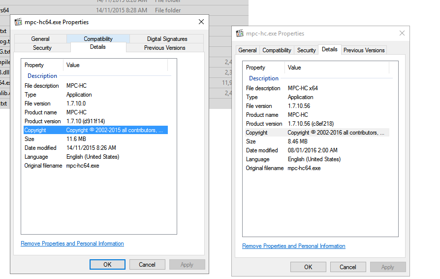

Using an older version (only slightly!) of media player classic now and i think the issue is solved. the popup did not occur again in what was previously a repeatable condition, happening every time i ran MPC. However since this is going to be a show machine, i will monitor for a day to make sure it does not appear again period.
Going from k-lite codec pack mpc version 1.7.10.56 and reverting to 1.7.10.0 has fixed the issue. I got the older version directly from the media player classic site.
I guess k-lite is just so on the bleeding edge that bugs like this come up. Anyone else having this problem should probably just revert to the an older MPC version and try again.

[Attachment 35442 - Click to enlarge]
