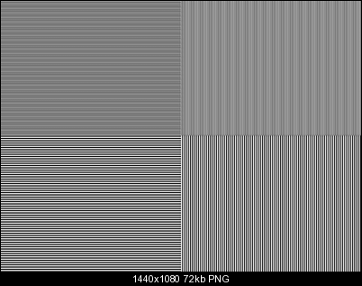

    Try resizing to 720x540 or 640x480 before upscaling to 1440x1080 or 1280x720. You'll find severe artifacts. The patterns are chosen specifically to show that it can't be done cleanly but you will find similar patterns in a lot of real world video. Blinds in a window, the pattern on the size of a skyscraper in the distance, etc.
    Spline36Resize(720,540)
    nnedi3_rpow2(2, cshift="Spline36Resize", fwidth=1440, fheight=1080)

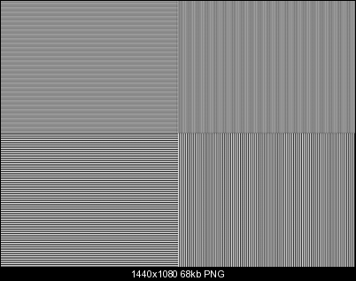

    But you can resize directly to 1440x1080 without severe artifacts.
    Be sure to view the images at their original size.

    Jagabo, thanks for the post. I can see what you mean by artifacts in the top left quadrant of the top image. I am surprised that resizing to square pixels then doubling introduces artifacts while doubling then resizing to square pixels does not. But, that is why I keep coming back to this forum. So much to learn about video.
