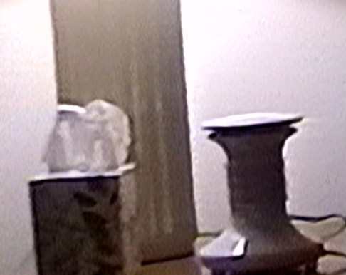

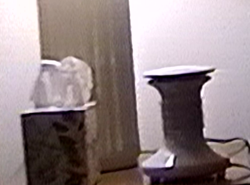

  26. Well, I figured out my problem was I had the QTGMC Preset = "very slow". After backing it off to "slow" it finally worked. I looked at two screen shots and honestly couldn't tell the difference. I will let you try to guess which one is which . But I am not too happy with having to scale back the preset to "slow". So I would have to go with my original method.
    Anyway, after fully processing through my workflow: AE -> PP -> Encore, I discovered that Encore chokes on 1920x1080p60. Well, maybe chokes is the wrong word. But after watching it struggle on my 15 sec test clip, I shuddered to think how it would struggle with an hour long clip. So I have scaled back to 1280x720p60 using the following which preserves the 4:3 DAR at 1:1 PAR. And Encore behaves smooth as butter now.
    nnedi3_rpow2(2, cshift="Spline36Resize", fwidth=960, fheight=720)
    HSN=10
    Crop(0,0,0,-HSN)
    Pillar=160
    AddBorders(Pillar, 0, Pillar, HSN, $000000)

    I could not tell which belongs to what, those samples. Maybe straight lines at the shallow angle would reveal a difference if there is any difference at all.

  30. Originally Posted by SameSelf View Post
    Try with this video.
