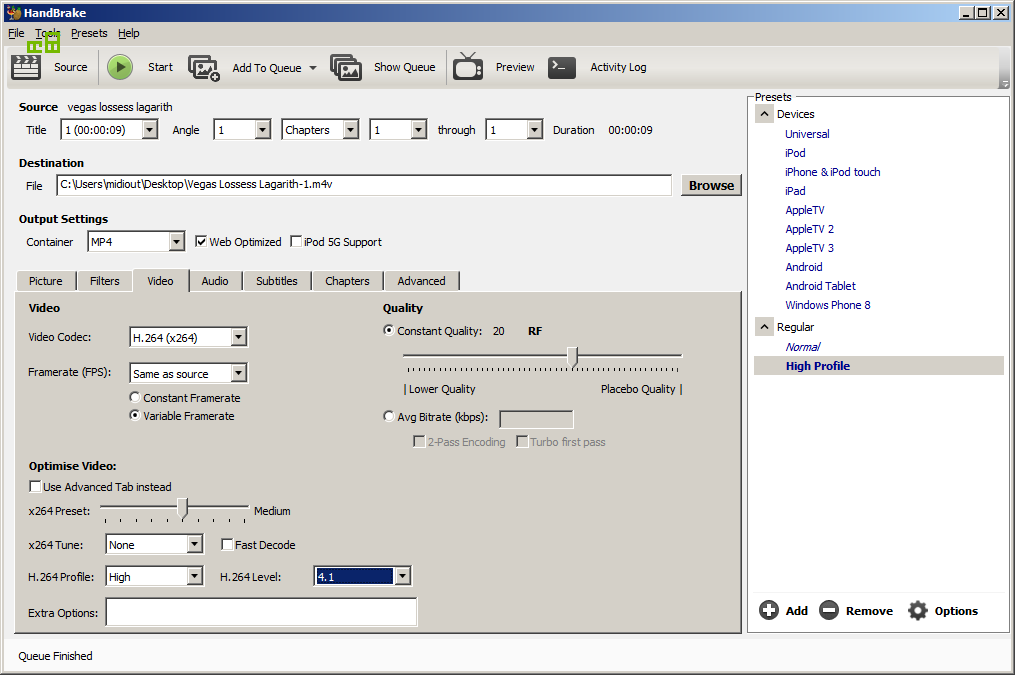

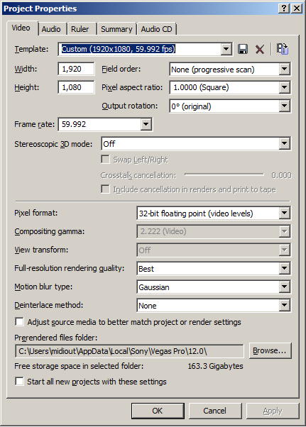

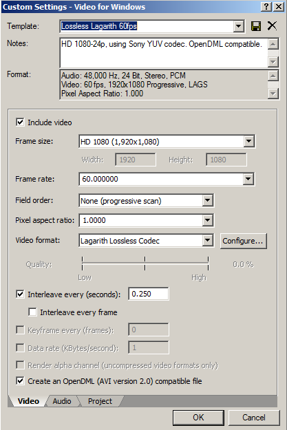

    Project Settings
    Render Settings (Video for Windows .avi)
    Handbreak settings
    I'm sure all of these other details after the source video were pointless, seeing as the source video looks to be the problem itself?
    Talking to this person he's told me he achieved that quality by recording with Shadowplay (like I have), compressing it by 'about half' with handbreak and uploading it. His footage looks perfect.

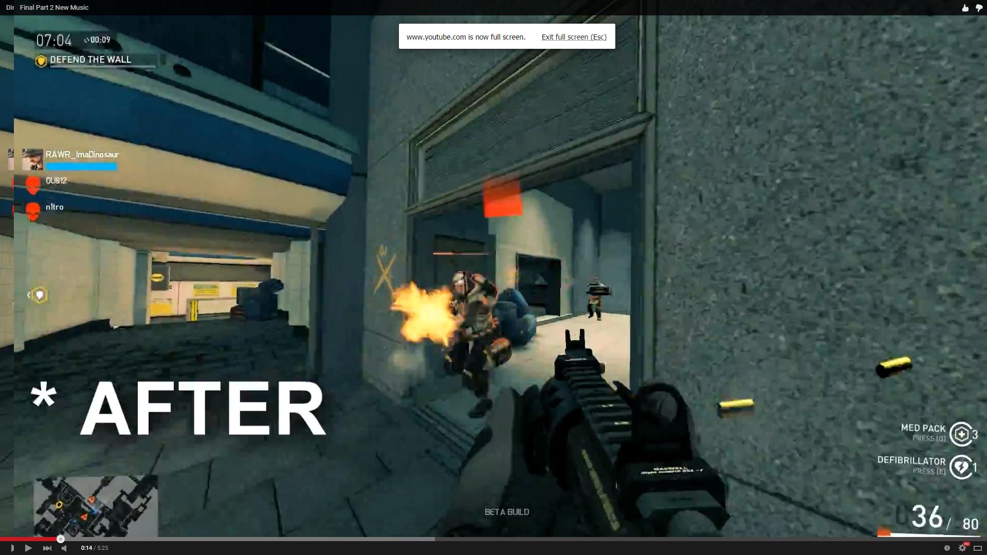

  17. Sorry for the delay, I must have deleted the video so I had to re-upload it. Both videos were recorded with Dxtory using Lagarith at 1080p 30FPS. Rendered with Sony Vegas with Windows Media Video V11, Quality VBR, 86% Quality and no further compression other than you tube.
    Here's the before:
    https://www.youtube.com/watch?v=17IyANQp0AU
    https://forum.videohelp.com/images/imgfiles/RbB4ix4.jpg
    And the After:
    https://www.youtube.com/watch?v=eVTsneG4vbw&feature=youtu.be
    https://forum.videohelp.com/images/imgfiles/2dmmpJE.jpg
    Again this is the same project file, project settings, source files and render settings. My videos would consistently look like the before clip every time I uploaded them, no matter the content or length. Now they consistently look like the second video, no matter the content or length. You could see my enemy's eyes in the first example, now you cant even tell if he has a face.
  18. You messed something up because the durations are different . Your overlays are slightly different, different text, but that shouldn't affect it too much. But you're screenshot frames aren't even the same. You could be comparing an I frame vs. B frame for example - that' s just for future reference when making proper comparisons
    BUT - when examining the downloaded videos, the newer version is definitely worse, a lot worse. Almost everywhere (there are a few frames where the new version is slightly better, but very few). And the "old" version isn't that "old", June 15,2015
    So unless you did mess something else up other than the duration, something different is going on between June 15 and now...
    Sometimes it takes a while for YT to process a higher quality version, but I don't think thats the reason here. Maybe this is happening to everyone, everywhere, across the board for YT ?

    Getting someone else to upload a video, is to circumvent youtube's detection. You can't upload the same video to the same account (it will detect the duplicate). Additionally, there have been some theories that users in certain countries get better service/ better encodes than others. Maybe there are more servers in "xyz" location etc.. (having more servers, more distribution for a single encode will reduce the quality) . None of that has been conclusively proven
    As far as it being my process or computer and not youtube. Assuming for an extreme example my hard drive or ram were screwed up in some way, the render may end up being a mess, maybe not visually during playback, but in the back end. This would lead to a poor upload for me or anyone else I ask to upload the video for me.
    No , if the render is a mess, it would be a mess for everybody visually during playback. It means the video is a mess.
    But you're not uploading a mess. You said it looks fine locally. You're supposedly uploading something similar to what you uploaded June 15. If youtube was the same, then you would get the same (or very similar) results
    The problem isn't what you are doing. As long as you have something that looks decent locally before you upload.
    Or there's the idea that other youtubers small and large, seem to be having no problems uploading footage of this same game. In which case I'd be looking to ditch my process entirely and look to find something new and improved on what I'm doing (my main reason for reason for creating this thread). Sure you can say their videos have more down time, or still frames, different frequency of dark/light/moving scenes. But generally the product we're putting out is the same and they have a consistency in their video quality no matter the amount of motion or colors. Their videos look great if the entire thing is nonstop action and motion, in dark areas, in light area. They put out a good consistent quality and I'm looking to achieve that. Though I do understand my videos having different content causing differences in quality, I also have no idea what their recording and rendering settings are.
    It doesn't matter. That's the least important difference. You seem fixated on what your process or their process is as if it will make a big difference. It doesn't.
    There are a bunch of things you can do to optimize, reduce the compression requirements for YT to handle, but the end result is minor.
    So opposed to the idea of trying to determine what is similar or different from my two uploads, maybe it's in my best interest to ditch my previous attempts and start over. Maybe I should try what would theoretically yield results up to the standard I'm looking for (though I don't know what that process would be). I do appreciate anyone who's attempting to assist me , I feel like I may be coming across aggressive and I don't mean to be. I'm just trying to get on a level way of thinking about this problem/solution, though I don't have the knowledge about video creation/encoding that anyone else here does. This entire situation has been sort of annoying, going through this trial and error for the last week I feel a bit defeated.
    To be blunt, you're trying a bunch of things and wasting your time. It's not how compression or youtube works. (and you have tried a bunch of things, but nothing worked , right ? )
    My guess is that there has been some change in YT recently. At first I wanted to brush everything off to content differences for those other videos (and it does make a difference, it's easy to prove and has been demonstrated before) but that difference in your June 15 vs. Today test is too large, assuming the "today" test was done correctly - it suggests something else is going on
    Perhaps they are distributing their encodes more (cutting up into more pieces across more servers), that will reduce quality. But there are fewer reference frames in Today's encode, and that does reduce quality. Why did it do that today, but not June 15 ?
  28. Well since I no longer have the exact same rendered videos from my previous uploads I have no real way of saying it's the absolute EXACT same footage. But it is the same source footage rendered with the same settings.
    About the render being a clean(locally) and getting to youtube and being inconsistent. I feel like there has to be more to it than that. For example, I have a video that looks quite crisp there's a very slight noise to it, based on me using a different program to record it. With that noise the gamma is very slightly brighter. Now in terms if saying it looks fine locally, it's very clear, no distortion or artifacts, everything is very defined but once that slight noise hits you tube it's a total mess. Maybe my idea of what looks good during playback isn't in par with someone who's more familiar and knowledgeable with video footage. In a similar way that an audio engineer would know how to EQ and mix a song where as a consumer already thinks it sounds great because it has a lot of bass.
    I almost want to drop the idea of Youtube having changed something and try to move past that. If they have changed something it doesn't seem to be affecting anyone else. Other YouTubers uploading similar content of the same game after June 15th with fantastic quality. I feel like they didn't just get 'lucky' since all of their videos look great, every time. In that case I'm basically asking, 'what do I need to do in order to achieve the same quality of this person', or 'what can we assume these people have done in order to achieve this?'. A lot of people are out there making videos now not having the problem I amm so I want to theorize what they are doing differently than me in order to get these consistently great videos (even after June 15th).

  30. Definitely, noise impairs compression efficiency. Recall that's how video compression works, by storing the differences between frames. Noise by definition is random, and will make adjacent frames appear to be "different" in compression terms
    But if we extend this to youtube - it has to be quite noisy to make a big difference. If you want someone to check it out, upload something that you would have uploaded to youtube
    But that is one of things that people do to optimize mentioned eariler - they denoise to improve comrpession efficiency, they add things like motion blur. A video that is more blurry is easier to compress for YT than one that is razor sharp. The "lower" quality video will often end up looking very slightly better . Again those are minor differences, not major.
    But 99.9999% of youtube user just upload it as is. They throw it into something like handbrake.
    The quality differences between the other videos can all be explained by content differences. For example, pauses, peripheral overlays (in the 2nd video), less action, dark video with limited colors (the 3rd video) . This is all easy to prove, and has been proven before. It's how compression works.
    However, the June 15 vs Today test cannot be easily explained. Those are unexpected results, assuming you uploaded videos of similar quality .
