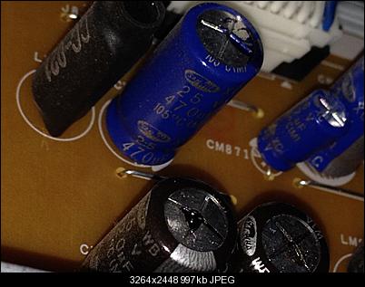

  17. The TV is 8 years old?
    IIRC, that's about the time Samsung was using shitty Chinese capacitors. And lots of owners have had similar problems.
    Samsung had to change suppliers, and the problem was discussed a lot on sites like videohelp, avs, etc.
    I hesitate to say, because if someone is stupid about it, well...
    Anyway, if you unplug the TV and leave it unplugged the better part of a day, it will be safe to take the back off.
    Look for any bulged or leaking capacitors (those things that look like miniature beer cans).
    A good many people have been able to use a soldering iron to replace a bad capacitor with an equivalent new one.

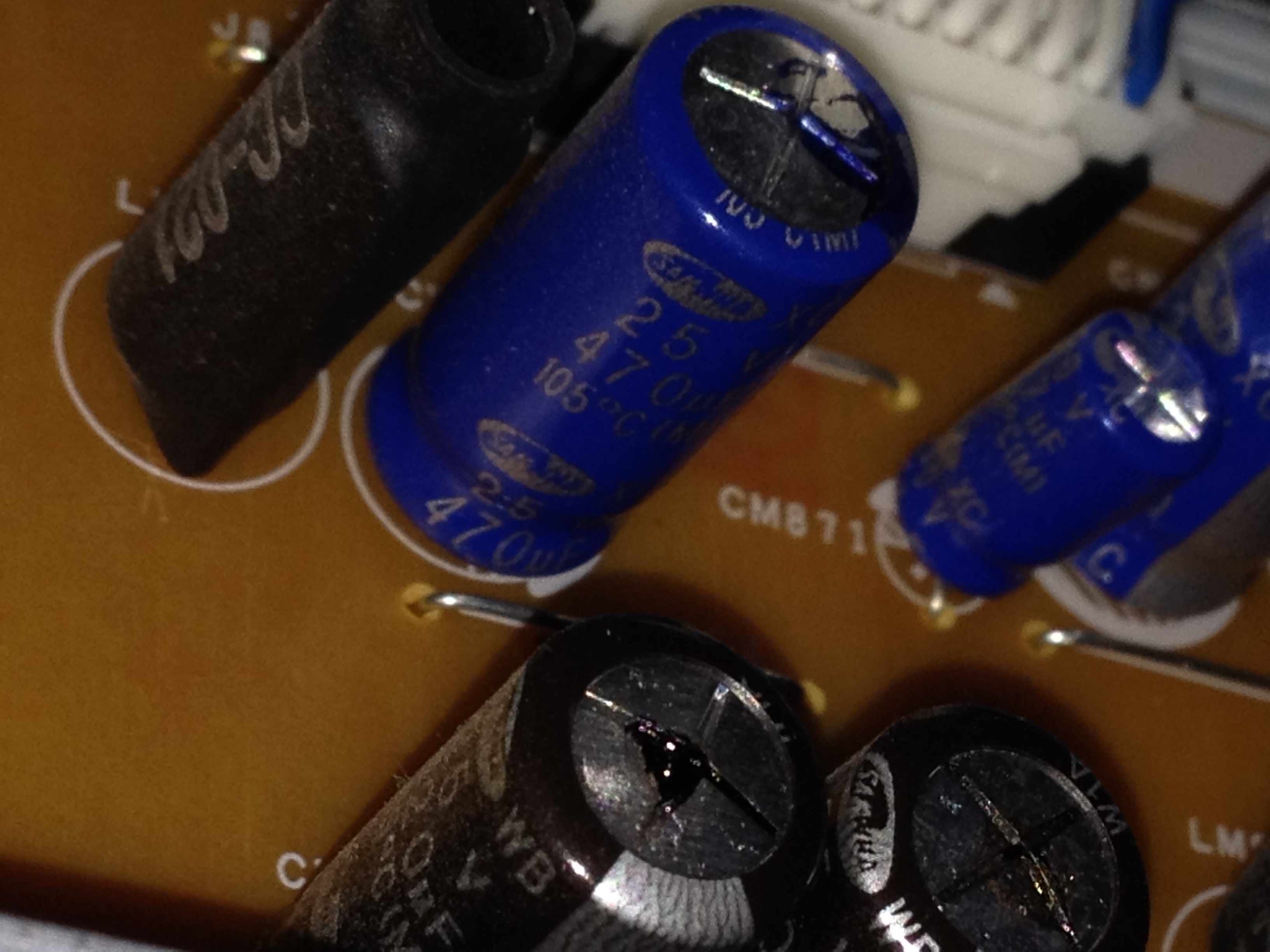

  25. i found 6 blown capacitors:
    i see they are 25V, 105C, 822uF? and 4.7 something...
    i couldnt find similar ones in Fry's. so i am ordering soldering kit and capacitors from ebay. it's prolly going to take a month before i can work on it.
    i hope i dont need the tool to suck the melt solder lead.
    it can be an opportunity for me to quit wasting time watching tv. dang.

    Most likely you will need copper wick to remove excess solder,never use a solder pump to remove solder from delicate circuits as there is a good chance you will suck up the traces as well.
  27. it's almost a month since i opened the tv up. i cannot wait any longer for the 470uF capacitors to arrive. so i use 820uF capacitors in place of the 470 ones.
    after replacing 4 capacitors, my tv is back!
    total i've spent: $10 including the solder kit and the capacitors (15 total) from ebay, and quite a few hours. the cheap solder kit is not very powerful, but eventually got the job done.
