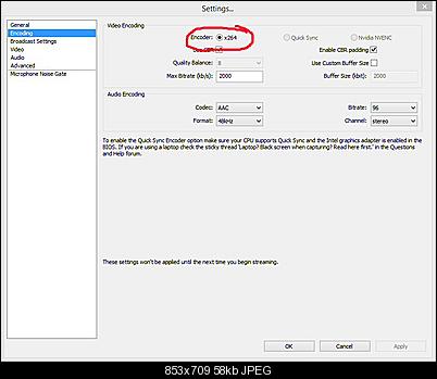

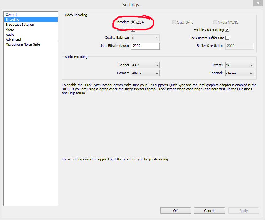

    No, OBS won't do what the OP wants. It doesn't use the device's own hardware encoder. OBS can only use the Elgato Game Capture HD's drivers to access the decompressed video from a previously compressed stream. OBS uses x264 to re-encode. The result will be the same as if the OP used x264 to re-encode a file recorded using the Elgato Game Capture HD.

    ...but let us leave the Elgato Game Capture HD's unusual Direct Show drivers out of the story for a moment. The Elgato Game Capture HD uses USB 2.0 to connect to a PC. USB 2.0 does not have enough bandwidth to provide an uncompressed HD video stream at 25 fps or 29.97 fps. Also look at the instructions in your link. OBS is using x264 to encode, not the Elgato Game Capture HD's hardware encoder. So, explain how OBS is not re-encoding video originating from a previously compressed stream?

    The Elgato Game Capture HD cannot capture video as an uncompressed stream because it has a USB 2.0 interface. That means OBS is using x264 to re-encode a previously encoded stream. (The compressed stream stream is automatically decompressed by the Elgato Game Capture HD's Direct Show drivers. The drivers do not allow access to the compressed stream.)
    Of course OBS can encode at a higher bit rate than the hardware encoder supports. ...but re-encoding at a higher bit rate won't improve the quality over that in the compressed stream from the Elgato Game Capture HD. If you think that it can, you know nothing about video capture.
    The OP wants to tweak settings for the Elgato Game Capture HD's own hardware encoder, which OBS clearly is not using.
