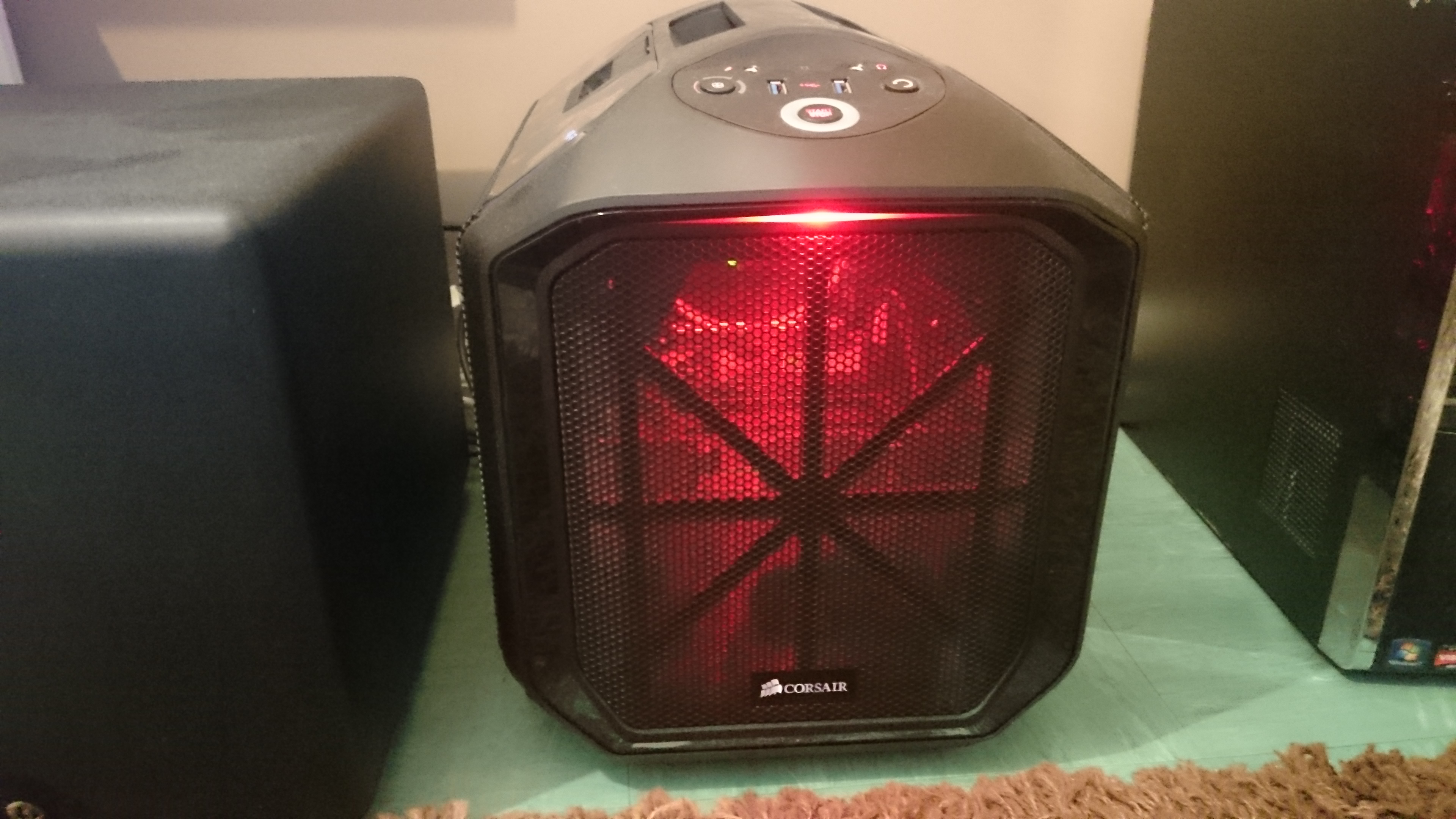

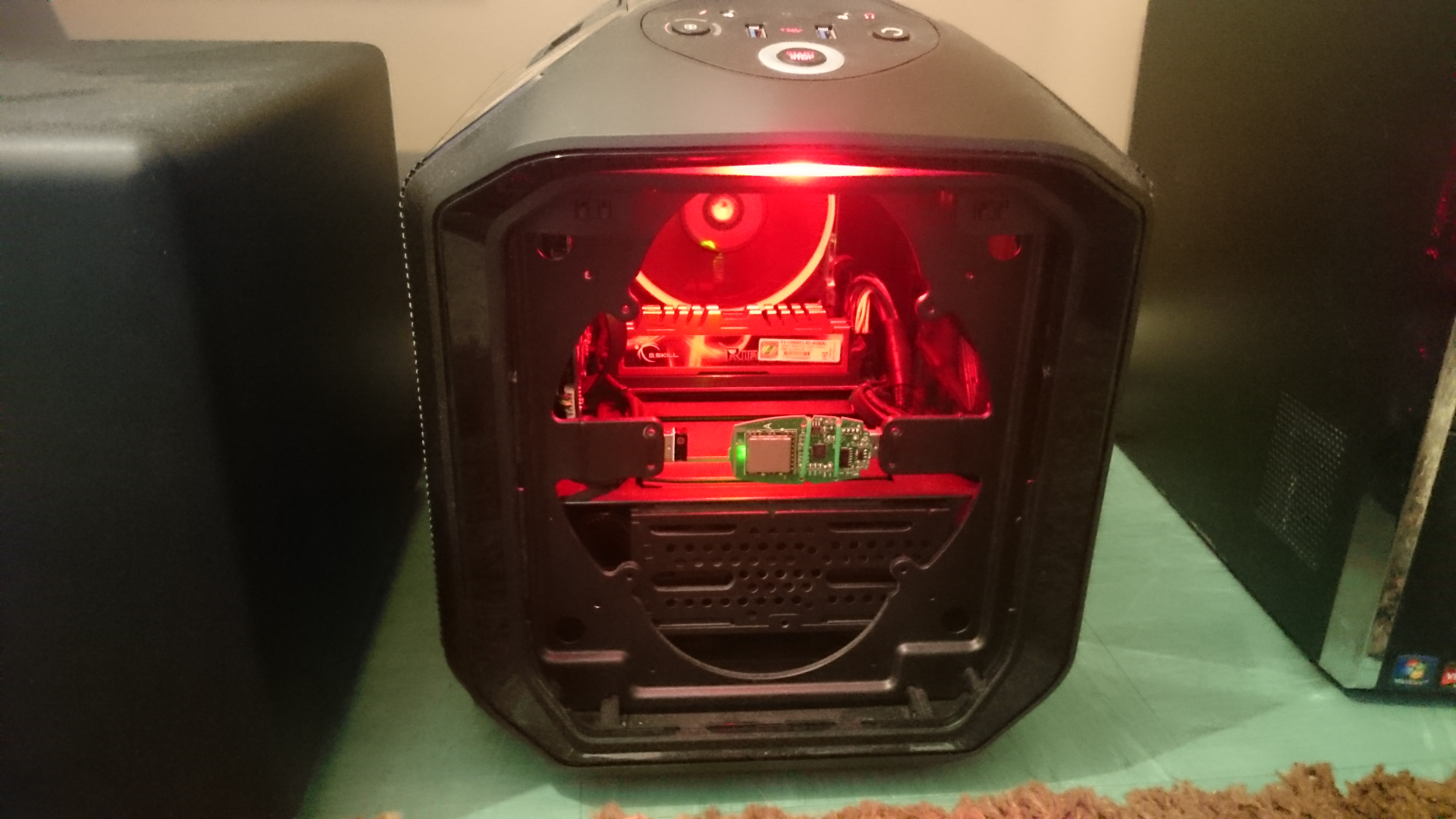

  4. Plenty of room for a slim after moving those dongles, can also maybe just about fit a 165mm lg full size in there with some dremeling but its going to be sooooooooo tight and thats if im lucky. Fittings can be created easily enough for either drive. Would rather not change case, its something ive been mulling over for weeks now and thats the decision for various reasons.
    Please excuse my lack of foresight.

    Recommend against putting a slim drive or anything else that's not intended into the case. Cases, especially mini cases like yours are optimized for airflow in a certain way. Anywhere you place the drive will imepde airflow from the fan and add additional heat from the drive.
    There's also the issue of power. There may not be enough power for an additional device. Bottom line is, if an additional drive could have been included, there would be an empty space for it.
    As suggested above get a full size drive with a good included or aftermarket case and run an external fan across it while in use. The primary reasons for failure of external drives (burners or hard drives) are heat or a poor power supply.
    Jul 2007
    Did a quick search and it seems this a Corsair 380t. Is this correct? If so, it's a lot bigger than it appears in your pics and you could probably mod the rear 3.5" drive bays rather than the front.
  9. Yup thats the case, it has no rear bays tho. I think im definitely going to go with a full size drive and just run it via esata.
