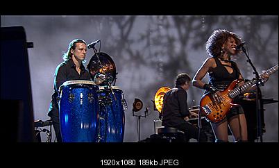

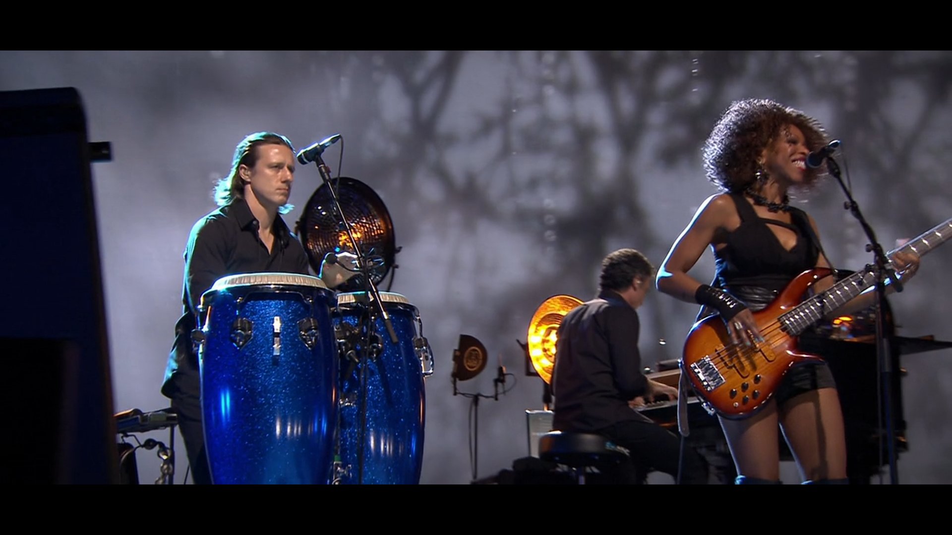

  2. I'm still waiting for newpball to offer an example of 1080p video that'll suffer if it's downscaled at all. And waiting, and waiting.....
    A picture documentary of today's workflow. Checking how much quality would drop according to bitrate and applying filtering etc. Uploaded as jpgs so as not to hog too much bandwidth. This time, instead of using the player's File/SaveImage menu, I used the printscreen button on the keyboard to show exactly what I'm seeing on my TV when the encodes are running fullscreen (don't compare the thumbnails because the forum software sharpens them). So, as seen on TV (mine).......
    1. Original Bluray video 30Mbps:
Name:	1 original 30Mbps.jpg
    2. Re-encode, no filtering, CRF18, 11Mbps:
Name:	2 No Filtering CRF 18 11Mbps.jpg
    3. Re-encode, no filtering, CRF20, 8000Kbps:
Name:	3 No Filtering CRF 20 8000kbps.jpg
    4. Filtering to fix the jaggies as much as possible. I'd still like to know how they were created. See the top of the bongos.
    1080p CRF20, 7000Kbps:
Name:	4 With Filtering CRF 20 1080p 7000kbps.jpg
    5. With Filtering, 720p, CRF 18, MPC-HC with Bicubic upscaling, 4700kbps:
Name:	5 With Filtering CRF 18 720p 4700kbps.jpg
    6. With Filtering, 720p, CRF 18, MPC-HC with Bilinear upscaling, 4700kbps:
Name:	6 same as number 5 soft resizer.jpg
    Give #5 hardly looks any worse than #4 and definitely better than the source, it looks like it'll be 720p again for a 25.5Mbps bitrate reduction. Although I might go down to CRF16 for this one.
    As is often typical, the 720p version doesn't take a noticeable quality hit unless a fairly soft resizer is used (ie #6) but most players/TVs would have much better upscalers.

    You think that #5 "definitely" looks better than the source Blu-Ray?!? I strongly suggest that you set up an appointment with a good eye doctor, asap.
  8. I think his goal in #4-6 was to fix the jaggies. The are reduced, but the fine details are reduced as well. You can't have your cake and eat it too
    Whether or not it looks "better" is subjective. You can argue it either way, but I think ideally those jaggies shouldn't have been there in the original (i.e not great source quality)

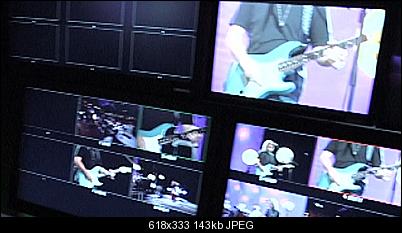

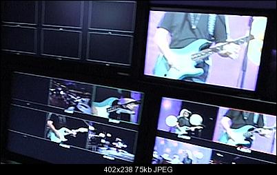

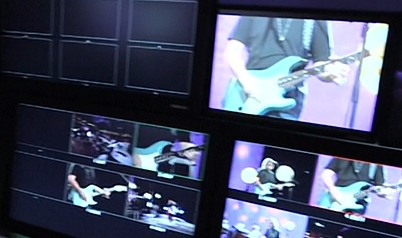

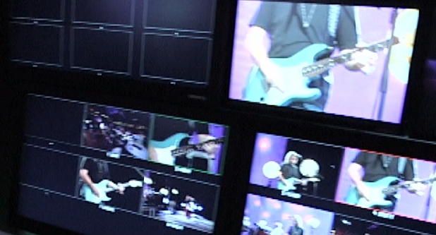

  16. Originally Posted by sophisticles View Post
    I think that's because you're nutter enough to claim it doesn't even if it does, if it meant you'd have to acknowledge you're not always right.
    Yes #5 looks better than the original Bluray. No question. The jaggies are gone and the edges of objects are cleaner. FFS, just look at the strings on the guitar or the light reflecting off the edge near her hand. Do they really look more natural in the original video?
    In case you've never encoded a video before or posted without thinking, 90% of the difference you can see in respect to fine picture detail between #5 and the original is a result of the filtering to remove the jaggies, not the resizing, so if you thought you'd found an opportunity to make a derogatory comment about downscaling you're out of luck and only managed to help newpball make himself look silly again. For the record, I used nnedi3 to throw away every second scanline and replace them with interpolated versions, then I downscaled to 720p, and finally I ran QTGMC in de-interlacing mode on the progressive video to stabilised any remaining jaggies (after a fair bit of experimenting it seemed to be more effective than running it in progressive mode). Naturally that process effected some fine detail in places but if you look carefully at the background you'll see it also cleaned up a bit of noise, and you might see it also reduced any encoder blocking..... because yes, despite the 30Mbps bitrate there was some fine blocking in places, especially where the lighting was changing quickly. Does #4 look better than the original? Of course it does, but any "which looks best" nitpicking while comparing screenshots becomes completely irrelevant when the pictures are moving, aside from the encoded version looking a little "cleaner" and the artefacts from the bad de-interlacing (or however the jaggies were created) don't jump out at you. In the original they move as objects or the camera moves. In the encoded version even where I didn't always eliminate them, they're far less obvious.
    Original:
    Encode:
