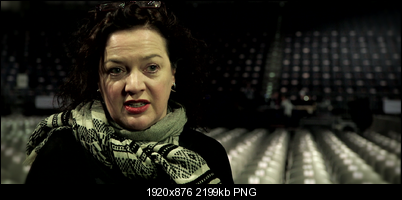

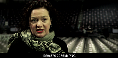

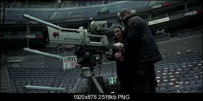

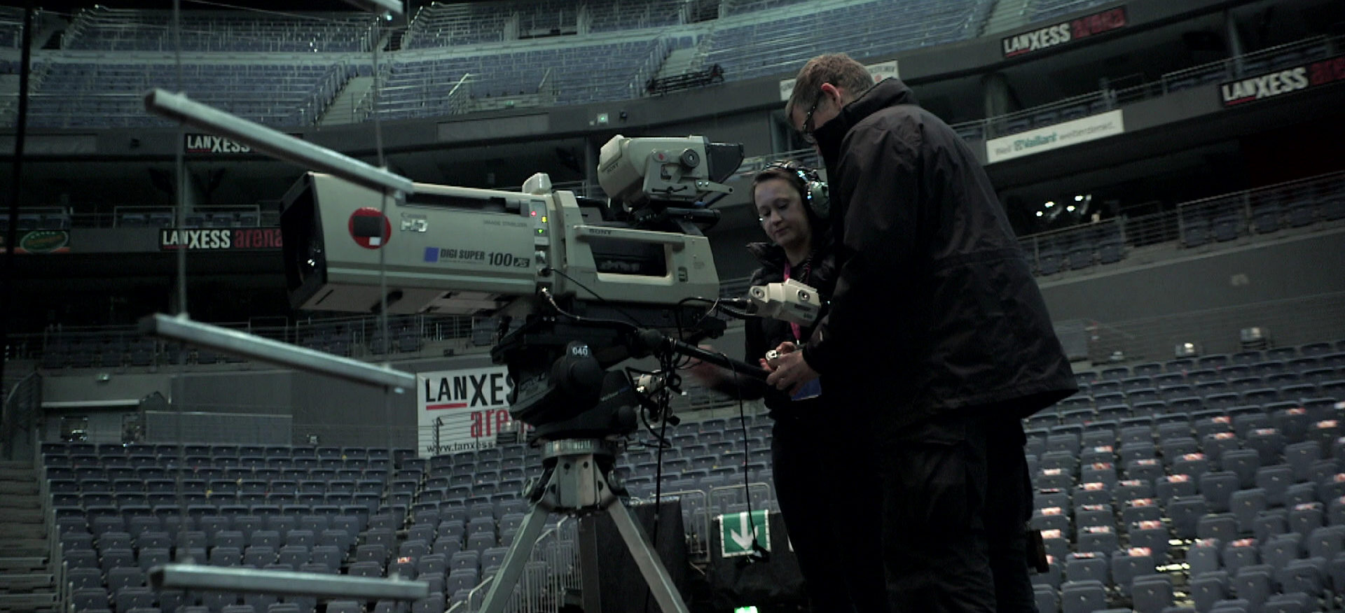

    From the Bluray video I'm playing with at the moment. Uploaded as PNG. Nothing spectacularly detailed, but certainly not "utter crap". I couldn't find a single shot I could downscale to 720p and back and see a loss of detail. The top pic is the video opened with the following script:
    LoadPlugin("C:\Program Files\MeGUI\tools\lsmash\LSMASHSource.dll")
    LWLibavVideoSource("D:\T1_Video.lwi")
    crop(0, 102, 0, -102)
    The bottom pick in each example was opened with this script:
    Spline36Resize(1280,584)
    Spline36Resize(1920,876)
    If you check the file sizes you'll see the second pic is a tad smaller than the first each time. Less info to compress, I imagine, but how much loss can you see? I picked the first shot as there's already some aliasing in the pattern of the scarf and I wanted to see what effect the resizing would have on it.

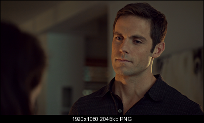

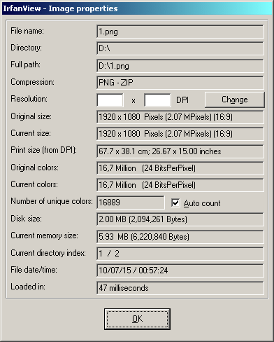

  13. Another one for newpball to pretend isn't there. 1080p down to 540p and back this time. Note the difference in file size.
    1080p = 2.0MB
    540p and back = 1.3MB.
    Can you see the missing 0.7MB?
    LWLibavVideoSource("E:\1080p.mkv")
    Spline36Resize(960,540)
    Spline36Resize(1920,1080)

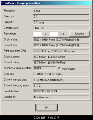

    According to Irfanview I removed 168 unique colours by resizing to 540p and back. Bummer....
ID:	32492Click image for larger version

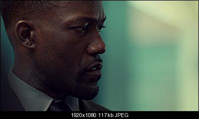

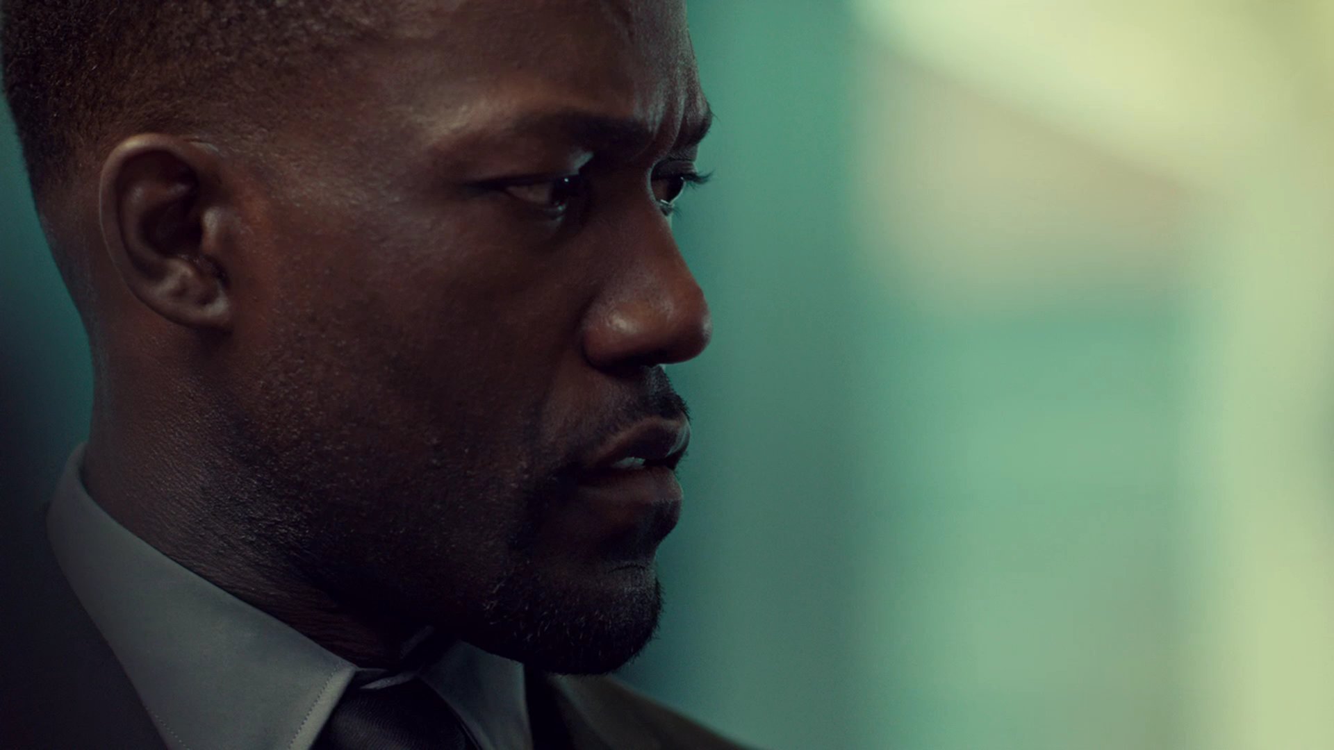

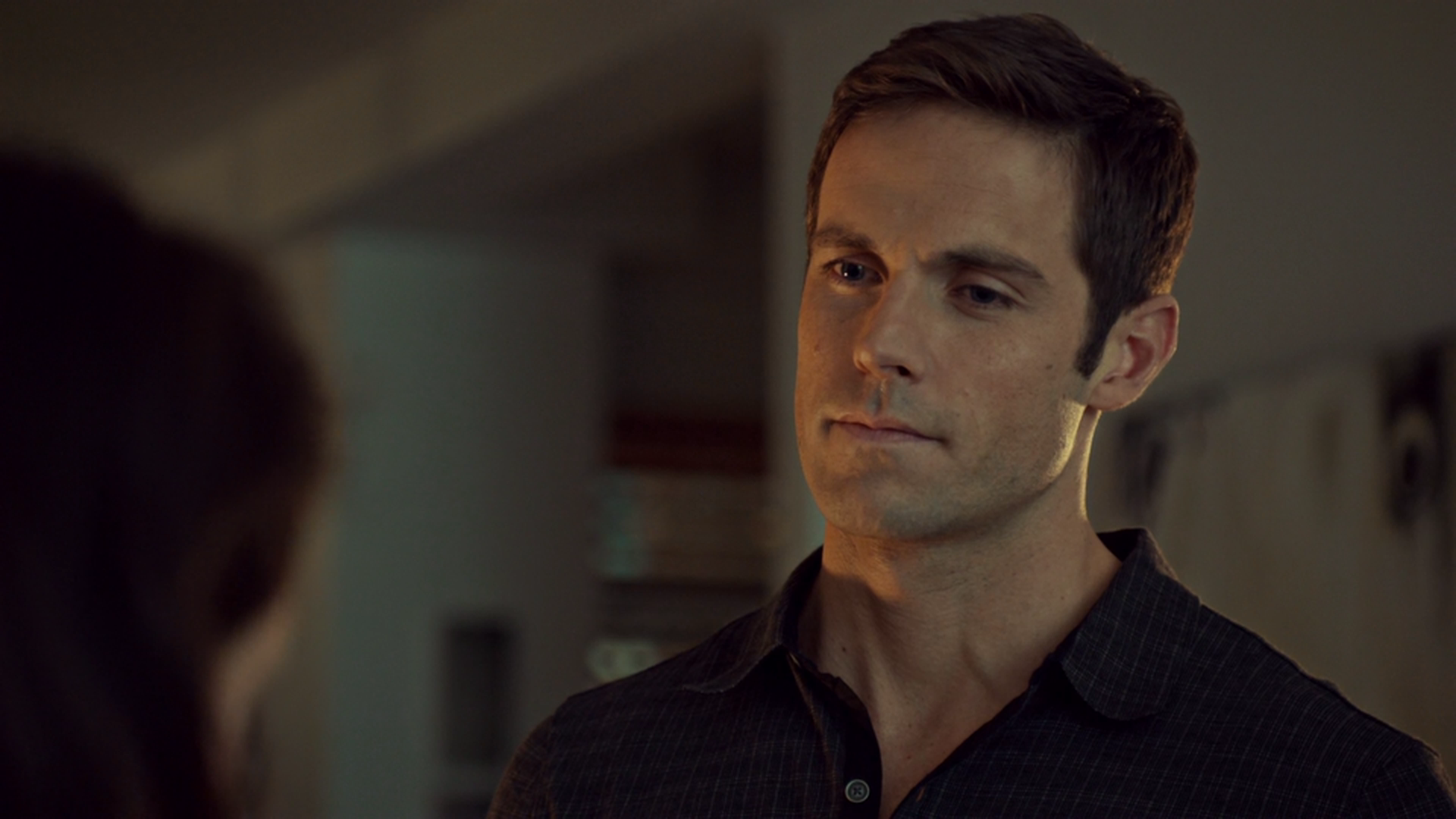

  14. Just saved as jpegs this time, but all the way down to 540p and back and there's a little quality loss beginning to show.
    1080p
    720p
    540p

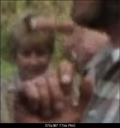

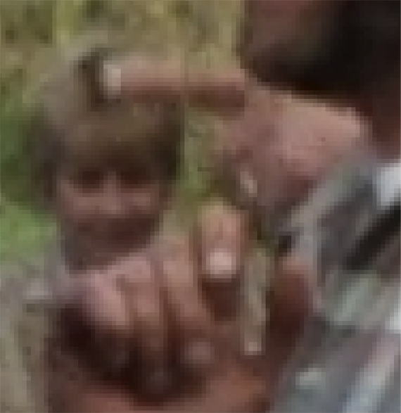

    Here is a magnification of the picture you claimed came straight from a blu-ray:
Name:	no grain.png

    Of the examples I posted earlier, the pics in post #42 are from the "making of" documentary, directly from the "Joe ****er, Fire It Up" Bluray. Untouched by me. The following posts contain screenshots taken directly from a 1080p itunes video as that's what I had handy.
    You go on about resizing 1080p as though you'll always lose detail and I've proved several times that's not always the case. I've used Bluray video as an example and I've used iTunes video as an example. It doesn't matter where the samples come from, and it doesn't matter how many excuses you decide to offer, some 1080p video doesn't contain anywhere near 1080p worth of picture detail. At least not detail you can see. That's not my fault, it's just the way it is. Pick a Bluray video and show me an example of where I'm wrong. You should be able to. According to you every 1080p video will show quality loss when downscaled, and I've acknowledged you can't downscale every 1080p video without losing detail, but you can downscale much of it.

    Of the examples I posted earlier, the pics in post #42 are from the "making of" documentary, directly from the "Joe ****er, Fire It Up" Bluray. Untoched by me.
    "Making of", "Add-ons", "Extras" etc are often of far worse quality (MPEG-2 based videos made by die-hard stuffy old interlace lovers?) than the main video. Just saying!
    Just look at that picture you provided with that great Canon $200,000 lens, just about everything is out of focus!
    Seems to me that camera operator needs some lessons on the hyperfocal distance.
    Wouldn't you agree?
    If they used that for the main show and it did not capture anything close to 1080p resolution the whole production team needs to be fired.
  25. Originally Posted by newpball View Post
    "Making of", "Add-ons", "Extras" etc are often of far worse quality (often even MPEG-2 based probably made by die-hard interlace lovers) than the main video. Just saying.
    What, so you're saying not all 1080p Bluray video is the same quality with the same amount of picture detail????
    These are screenshots of "moving pictures", not photos.
    Your excuses are getting old.
    Okay..... you got me. I looked through the whole disc and found lots of shots where downscaling showed a loss of detail, but I picked a couple of shots from the "making of" that didn't and then I lied about being able to downscale the whole thing without quality loss, or whatever you think I did.
    FYI I picked those particular shots because they showed more fine detail than any of the concert footage. While the concert footage looks good it's much harder to find a still close-up where you can see fine detail.
    Are you going to provide any examples yourself or are you content with talk, talk, talk, excuse, excuse, talk, talk, excuse, talk, talk.....
