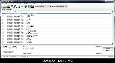

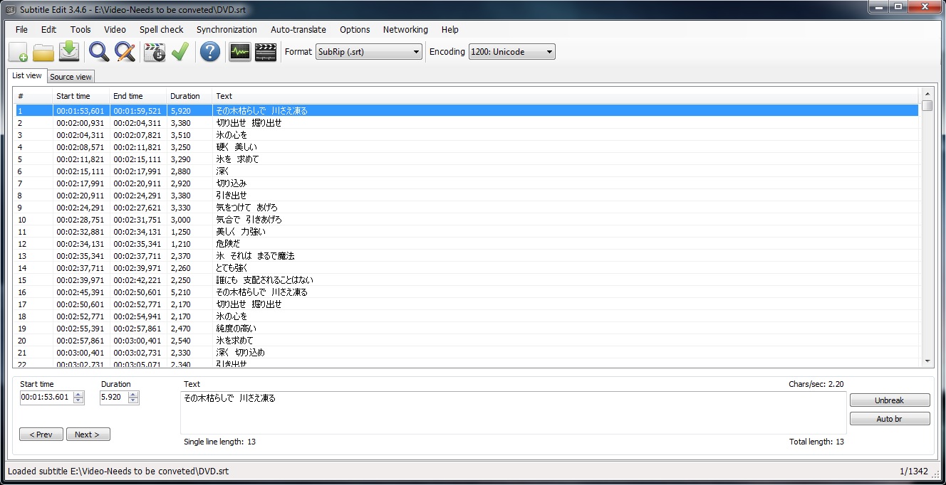

  1. I am trying to add Japanese subtitles to a movie that will end being on a DVD. It is an American title for which I downloaded an .srt file. I am sorry I do not recall the website, but I found the link in a different Videohelp thread. In VLC I can add my movie file and add the subtitle file and the only thing I have to do is change the font to a unicode font such as Arial Unicode MS or Lucida Sans Unicode and touch no other settings and subtitles work.
    I then opened up AVStoDVD added my video file. Imported that same subtitle file and changed the font as indicated above. Let AVStoDVD do its thing. Opened up the .ISO in VLC and the subtitles will not display when selected. I also tried changing the encoding to UTF-8 with Notepad++, but this causes it to display as squares. I used many different encoding and font options in VLC and was never able to get the subtitles to display correctly.
    I read about exporting the subtitles to VobSub (sub/idx). I imported the files into Subtitle Edit. Here is a pick of the main window after import.

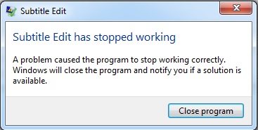

    Subtitle Edit crashes with the following error when trying to export the file to VobSub (sub/idx).
    I was also hoping for a selectable subtitle instead of hard subtitles, but I guess I may be running out of options and I have not even tried putting it onto a DVD yet.
    Thank you in advance,
    Vathraq

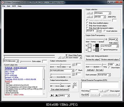

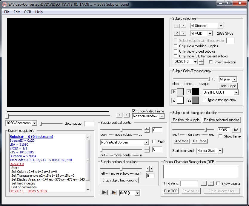

  13. I used DVDSubEdit. Here is a look at the main window.
    I am unsure if you are supposed to be able to view the subtitles in the preview pane while scrolling through the video or not, but I do not see any.
    A copy of the srt file. It was downloaded from opensubtitles. I am not sure if that makes any difference. I also included the sup file just in case that helps.
    Thanks,
    Vathraq

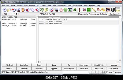

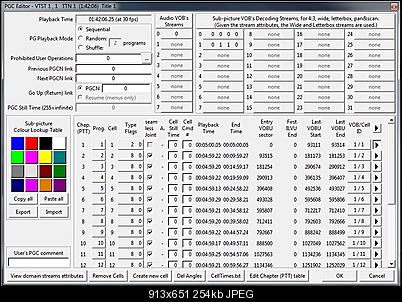

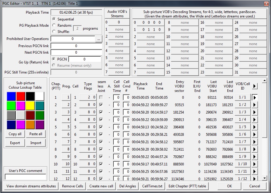

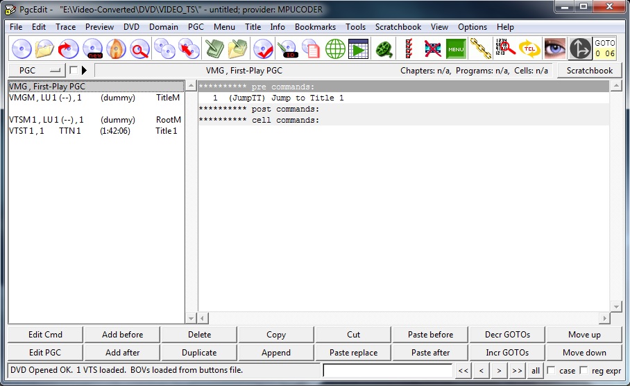

  14. Here is a couple of pics of the windows from PgcEdit.
    I have also included the text from the PGC Info.
    I do not know if any of this helps. Any help is appreciated.
    Thanks,
    Vathraq
    Yes, the first line of subs is supposed to show up immediately upon loading the 'Full Domain'. Based on the PGCEdit pic, there are subtitles, although nothing in the first stream, apparently. One thing you might try is in DVDSubEdit, in the upper right, where it says 'All Streams'. Hit the drop down box and highlight the individual streams and see if one of them has subs.
    Busy now, but will check out the SRT later on. Thanks for making it available and perhaps someone else might want to have a look at it in the mean time.
  16. One thing you might try is in DVDSubEdit, in the upper right, where it says 'All Streams'. Hit the drop down box and highlight the individual streams and see if one of them has subs.
    I did try that. No subtitles showing for any of the options.

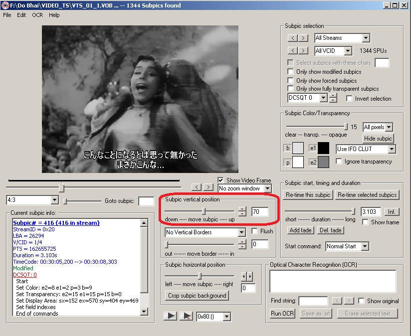

  18. Well, it seems this was a very simple problem. I was reading through this guide: https://forum.videohelp.com/topic338721.html
    Then I found these tidbits from monano in the comments for that guide.
    Yes, that's correct. Did you check the muxman.log to make sure they were muxed in? It's in the root of the C drive. Unless you've used Muxman again since then, (thus overwriting it), if you open it and if something went wrong with the mux, there should be some sort of a message.
    Next, let's make sure they're there, but not showing up for one reason or another (transparent, maybe, or too low to be seen). Open the VOBs in DVDSubEdit, all of them at once. Do you see them? Checking the SubPic/Transparency slider, is it all the way to the left, to "Clear"? Let's check their position. Does moving the "SubPic Vertical Position" slider bring them up into view?
    If either of those things helps, then after changing one go into Edit and "Apply Last Modifications To All", before File->Save All Modifications.
    While in there, you can also change the colors to whatever you like, unless using the PGCEdit method I outlined earlier.
    If neither helped, make sure the SUP file you made is actually good. Open it in SubtitleCreator (Tools->Manipulate SUP or VobSub->Open Sub) and see if you can read the dialog, and the timings look OK.
    It was very good advice. I adjusted the vertical position in DVDSubEdit and the subtitles popped up. Let you know how it goes.
    Thanks,
    Vathraq
  19. If you mux with subs, then when you turn them on with the remote control they should display. However, I think I figured out the problem. They're too low to be seen. Maybe they're fom a PAL DVD and being added to an NTSC DVD? Open the 'Full Domain' in DVDSubEdit and raise them about 70 pixels in 'Subpic vertical position', Then Edit->Apply Last Modifications To All->DO IT!, followed by File->Save All Modifications.
    Maybe this happens because I muxed your SUP file (which is fine) with an M2V and AC3 audio I had on the hard drive. If what I suggested doesn't work for you, then demux video, audio, celltimes.txt and subs using PGCDemux, reauthor with Muxman, followed by raising them as described before. Or maybe they were too low to be seen by me because I was adding a PAL subtitle to an NTSC video (all I have), in which case remuxing them should solve the problem. In any event, they play fine for me now in MPC-HC and will (I'm sure) on my standalone.
    In the off-chance it really is a problem with your player, maybe test out on a different player, maybe one at a friend's house.
    Testing the SUP file alone in both DVDSubEdit as well as SUPViewer shows all the subtitles.
    Edit: Oh, I see you discovered the same thing while I was writing. Good going. I'm sure you've solved the problem.
