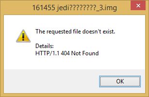

    Firmware link is dead.
  11. Originally Posted by mail2tom View Post
    Worked for me.
    I started uploading a youtube video on how to download the file, it should be up in 30 minutes or so
    https://www.youtube.com/watch?v=97ld_1_FL4Q&feature=youtu.be
