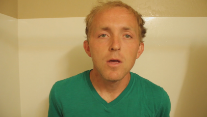

    Not having much luck with this 15 second clip in Vegas Pro. I duplicated the track a few times then tried to chroma key out the background colors but with poor results. I've exported an image sequence and worked on a frame in Paint Shop but then there's another 354 frames. Not looking to spend $ on a one time need and can't re-shoot. How would you handle removing this cruddy background?

    This was the best I could do in Vegas Pro.

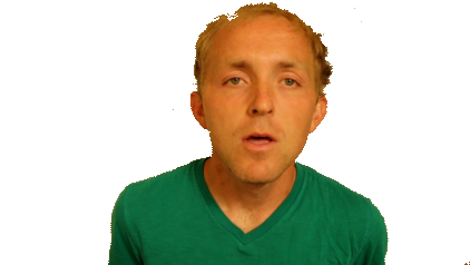

    The problem is lack of enough contrast between the subject and the background. This matte I made is not so good, because there's no room to finagle it.

    The background is not uniform in color so chromakey is not the appropriate thing here.
    Instead you need to rotoscope.
    I don't use Vegas but I doubt that Vegas has no rotoscoping capability.

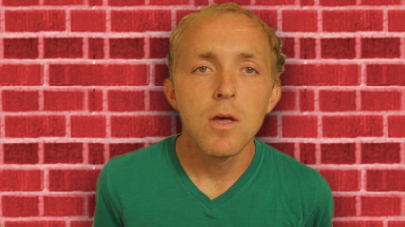

    I think frame by frame may be the way to go.
    This frame is in Vegas after processing.
    Shoulders need attention.
