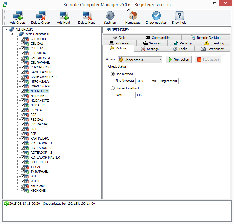

Hi mccoady,
SKIP any TP-LINK ADSL2 modem. All are horribles.
I have 2 modems (TD-W8961ND and TD-8816) using 10Mb connection from GVT...Problem, problem, problem.
If used torrent modem hang up. If in router mode, hang up. If Wifi for 6 devices, hang up...
In my long experience the most reliable modem is ADSL2+ Thomson Technicolor TG508v2.
Never give me any problem using 15Mb (17.5 real speed) from GVT.
Claudio -
