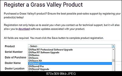

  2. 1) Go to http://www.grassvalley.com
    2) Sign Up and Login
    3) Click on Register a Product and fill info, serial number and other info not supposed to be right
    you can type anything:
    4) click on Save
    5) Click on View Registered Products and download drivers
    Drivers supported for XP 32bit
    [Attachment 32157 - Click to enlarge]
    4) click on Save
    Hi roma_turok,
    I have done so but could only find the "Canopus DV Driver" (CanopusDVDriver07.zip) which I have already tried multiple times with no luck, whenever I try to uninstall the driver it says that it can't find a compatible device (because the HardwareID doesn't match). Every time this or an earlier driver is installed, the card remains as a "Multimedia Controller" in unknown devices in Device Manager.
