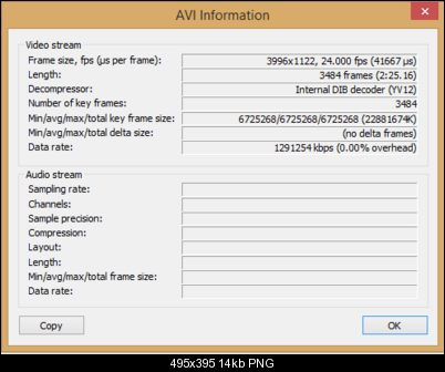

    Sorry for the lack of information.
    Resolution is still 2x 2K
  7. I added more to my last post. But why do you name the result of every filter?
