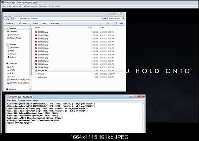

  2. You have the start and end numbers wrong. And you need to use a proper filename spec. This will work with the png files in the same folder as the avs script:
    LView=ImageSource("%06dL.png", 855, 860, fps=24, pixel_type="RGB24")
    RView=ImageSource("%06dR.png", 855, 860, fps=24, pixel_type="RGB24")
    And your original script loaded the "L" images into both LView and RView.

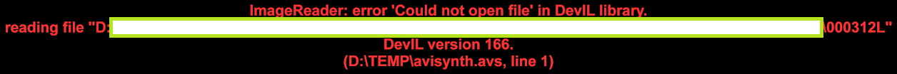

    I fixed the L/R letter, but it still gives the same error.
    Also, when I use the scipt in the same folder with your code, it still gives the "DevIL library" error.

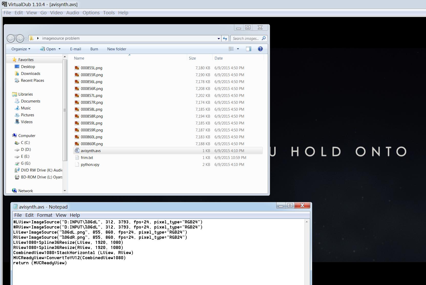

  4. Originally Posted by arthurm View Post
    Not for me:
    I'm using AviSynth 2.6 but I doubt that matters.

    weird! I'm also using avisynth 2.6.0 but virtual dub can't open it and gives the same error. Is there maybe something wrong with a DevIL plugin (it says I have version 166)?

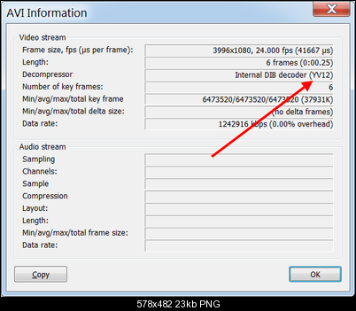

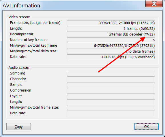

  9. I don't know anything about FIRM but YV12 is YUV420. And you script is converting to YV12. Open the script with VirtualDub and select File -> File Information. Verify that the script putting out YV12.

    @jagabo, VirtulDub does indeed give me that information. I've also tried it without ConvertToYV12. Virtual dub does work then but FRIM still doesn't.
