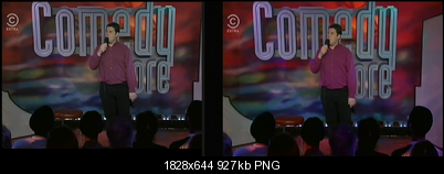

    I don't know what you did but all you need to do for a start is to correct the setup in the SD video.
    Left is yours, right is the AR and setup corrected SD capture:
    I don't use the Elgato but I would suggest you double check if you use the correct options when your capture, both for the setup (IRE) and AR because clearly what you got was a botched capture.
    [Attachment 32129 - Click to enlarge]
    I don't use the Elgato but I would suggest you double check if you use the correct options when your capture, both for the setup (IRE) and AR.
    Just helping here!
    Do you have a script so I can see what you're talking about that you want me to do? Because after my script the video is in the correct aspect ratio and it looks in proportion so I don't know what problem you're referring to.
