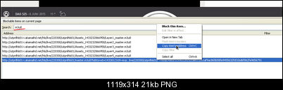

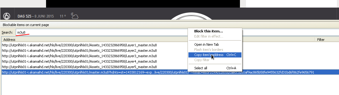

    hi
    1) find master.m3u8
    tools: firefox, adblockplus addon
    2) use livestreamer
    tool: livestreamer
    more info about livestreamer http://docs.livestreamer.io/
    livestreamer "hlsvariant://http://utpnlhls01-i.akamaihd.net/hls/live/220300/utpnlhls01/master.m3u8?hdnts=st=1433811153~exp=1433816553~acl=*/hls/live/220300/utpnlhls01/*~hmac=c04878c8597ff192d01e3cf7f66f7bd58d10d5785e089a40952440c6faa6ff98" best -o live-utopia.ts
    with in red the url find with adblockplus
