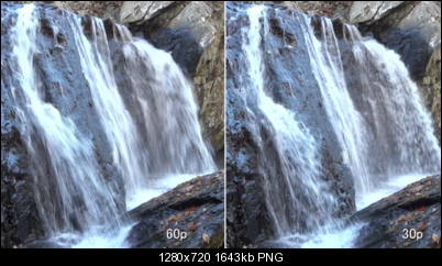

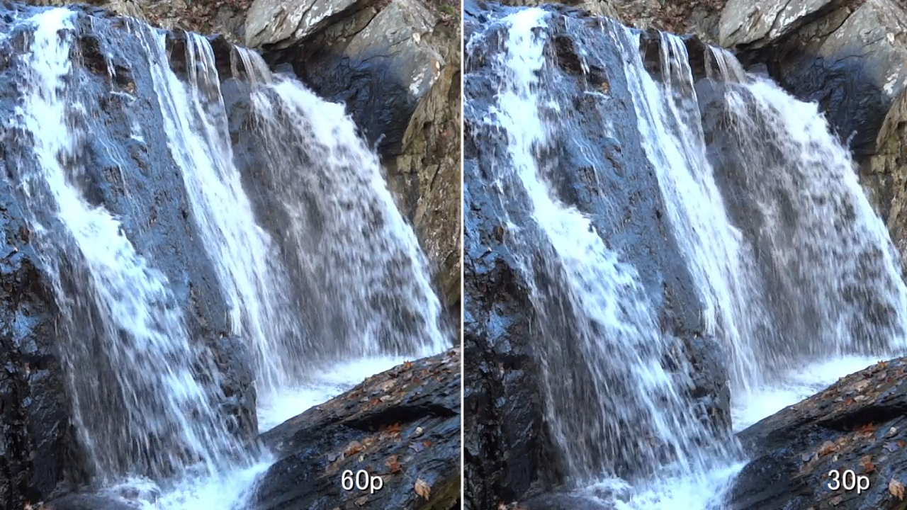

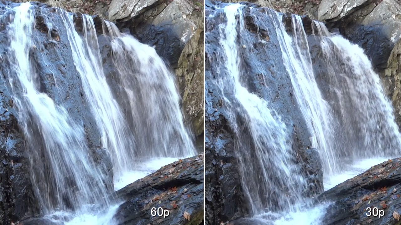

    Here is a side by side comparison of 60p vs 30p. I shot the footage in 1080/60p. The left is original 60p, the right is converted to 30p via decimation by 2.
  9. That is artificially made 30p, if 30p is shot with camcorder, then shutter speed would be slower than recording 60p, thus different than 60p to 30p conversion, which seems to always be kind of strobey, more than as oppose it was recorded 30p right away.
    But who knows, cheap camcorders can produce exactly that or even worse. Meaning shorter shutter speeds for your 60p original even calculated 30p.

    To riser-x: I looked at your footage and want to make sure I understand what I'm seeing. Attached is frame 16. I'm looking at a split-screen of a waterfall where one camera shot at 60p, then the same camera switched to 30p. I am not seeing the same motion shot by two different cameras at the same time with different frame rates. The 60p footage was then converted to 30p using a process described by poisondeathray. Correct?
    You are all correct in that there is a sense of smoother motion in the 60p, but the reason I am asking about 60p has additional ramifications, which I'll attempt to explain. Here's the short version, and you can tune out at any time.

  16. You are correct - It looks like racer-x didn't align the left/right views in terms of time, it looks like they are offset by 30 frames. Here is an "aligned" version attached below. To be clear, that is 1 camera shot at 60p. The 30p view is "faked" by dropping half the frames. The shutter was not adjusted (same shutter setting as 60p) so it's actually "more clear" than it should be with a native 30p shoot
    What software are you using to take screenshots ? The reason I ask is it looks "blurred" compared to what it should be. Perhaps your viewing software is contributing to your "blurriness" considerations? This is what it should look like on frame 16. Notice it's less blurred compared to your screenshot ? In fact, nowhere in his original clip could I find your screenshot. It looks like your screenshot was blended some frames together

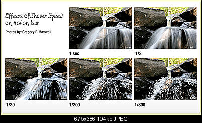

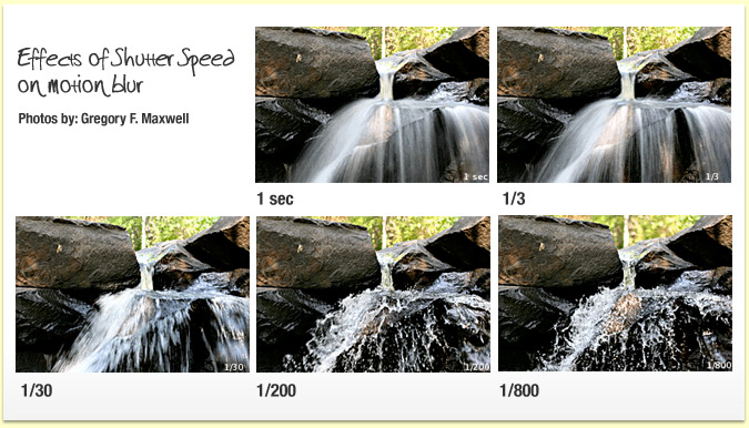

    If you're limited by CPU/ hardware/ sync software limitations and must record 30 fps, the only way to reduce the blur is to use a faster shutter speed. It's the exact same concept as shutter speed photography, so you can look at some photography examples to see the difference e.g. here is a random one (just look on google for shutter speed comparisons) . The problem is most consumer VIDEO cameras won't have as many manual settings as photography cameras; in fact most consumer level video cameras won't even let you control shutter at all. But indirectly, a higher frame rate will have a proportionally higher shutter speed on "auto" mode on those consumer models

    Yes I quickly put two versions together without properly aligning them, I didn't think it would matter at the time.
    After reading your intentions, I agree that a high shutter speed will help in your situation. Add as much light as you can to achieve a high shutter speed. The images will be clearer and allow you to focus better on movements. You can also look at the audio waves to better time the synchronization.
