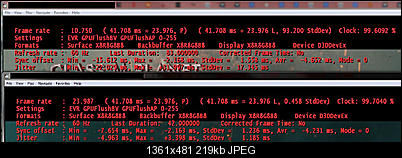

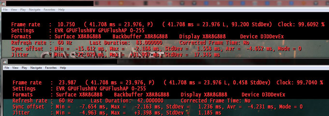

    I conducted a test between the products: a lossless conversion of a Bluray title to MKV. Yikes! What a difference!
    Check out the performance difference, when playing back in MPC-HC 64-bit (v1.7.9) on a Core i7 with 6 cores @ 3.2 GHz, 32 GB, and dual nVIDIA GTX 680's:
    * the top MPC instance is playing the MKV generated by CloneBD, and the bottom is MakeMKV.
    That's absolutely hideous! The CloneBD instance can't even hit half the target framerate of 23.976. These videos were playing simultaneously from the same position in the video track (my system can easily play multiple instances at full framerates, so don't point at me).

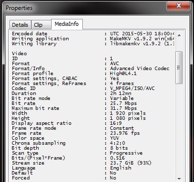

    Here are the video track differences when using each tool in "lossless" mode:
    CloneBD video track:
    MakeMKV video track:
