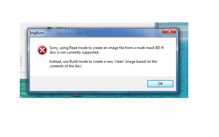

    Tried to make an ISO image with ImgBurn, but this is the message I receive when I go on the Read Mode Click image for larger version

    I tried with 4 different bds but the message is always the same.

    The message is suggesting that you use "Create image file from files/folders" to create the image on your HDD instead of using "Create image file from disc".

    Ok, try ripping the Blu-ray movie with MakeMKV or AnyDVDHD. MakeMKV is free to use, but you would have to use it in Backup mode. Put your disc in the Blu-ray drive, start MakeMKV, then let it find the disc. Then click on File-->Backup. Designate a spot on the hard drive to put the movie. Once on the hard drive, you can burn the entire thing to another disc using ImgBurn in Build mode.
    Using the trial for AnyDVD HD, you would start AnyDVD HD, put the disc in the drive and let the program analyze the disc. Then right click on the little fox icon at the bottom right of your screen. This will give you a pop-up window with options. You can either rip as an ISO with the command Rip to image, or rip as files. Burn to a new disc with ImgBurn, and depending on which way you ripped the Blu-ray, you would use the Write mode to burn an ISO, or Build mode to put the files onto the new disc.

    Everything is working properly now thanks to your suggestions.
