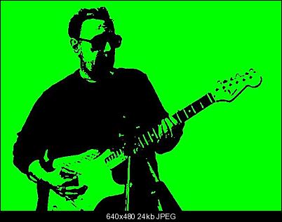

    1. I loaded the video clip into VirtualDub, went into "Video-Filters", added "Brightness/Contrast" with the contrast cranked
    up like crazy, added "Threshold", & adjusted it to then output 2 "binary" black & white clips (adding the "Invert" filter for
    the 2nd one). This took all of 90 seconds, and the results look like this:

    2. Wrote a quick Avisynth script which can output one, or more, color permutations of the black & white binary clip(s),
    (which, incidentally, has since evolved into a "function" script in case I ever have to do this again). For example:
    http://dedlykme.strangled.net/px/PossibleOverlays.png
    Now, the desired goal, (**and where I am stuck**), is to overlay/blend/merge (whatever...) two, or more, of the above
    resulting clips into one(1) binary clip that looks something like:
    http://dedlykme.strangled.net/px/UltimateGoal_SBS.png

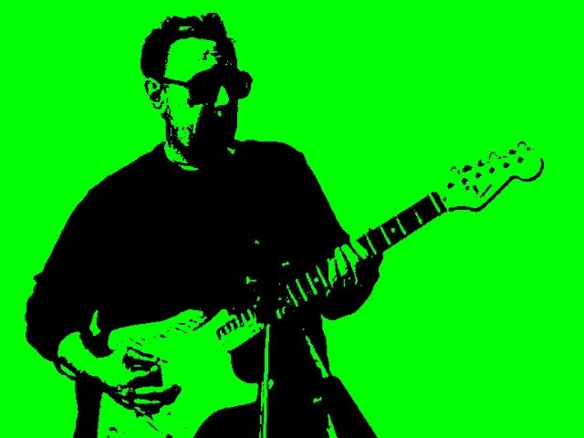

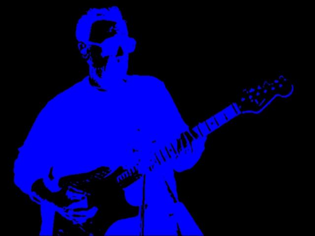

  7. So you have videos that looks like:
ID:	32072 Click image for larger version
    And you want to merge them to make:
    Something like this will work:
    Overlay(v2,v1, mask=v1.mt_binarize())
    If you still have the B/W video in the script you can use that as a mask instead of using mt_binarize(). Keep in mind that when using YUV video black is usually at 16 and white at 235. So you may need to perform a contrast stretch to get a mask with blacks at 0 and whites at 255.

    So..., I was already able to achieve that same result using the good old trusty ColorKeyMask() method by doing something like this:
    bg = m3
    fg = m6
    ckm = ColorKeyMask(fg, $000000, 5)
    Overlay(bg,fg, x=0, y=0, mask=ShowAlpha(ckm), mode="blend", opacity=1.0)
    It gets me into the ballpark..., but..., the problem that I'm having is figuring out an effective way to overlay that type of result onto
    the original source footage in such a way that it masks the old (lousy!) background, but allows the **entire** foreground subject
    (the guy with the guitar) to come through. With what I have now, for example:
    If I pull out the blue ($0000ff) it gets me close..., but I am left with a guitar player who has a nice bright green forehead & guitar.
    If I pull out the green ($00ff00)..., well..., I have the same old, unusable original background and a really pretty blue smurf-guy!!
    What I'm missing, I think, is some sort of interim step that creates a clip that (I guess) is "tri-nary" (Did I just make that word up?),
    so that I can use that clip to create one that is two-color (binary) in that the background is one color and the foreground subject is another.
    Perhaps some other overlay/layering "mode" or method that I am missing which, when two (or more) of the mask clips are combined,
    it blends/merges them into a usable result. Even if it is an "interim" usable result.
