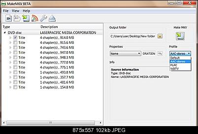

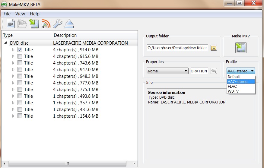

    When you set to Expert mode in preferences:
    May 2014
    Down the road, last house on the right
    Ah! My bad. Got me thinking there. Just discovered that myself and roma_turok beat me to it. It uses FDK AAC (libfdk.dll or libfdk64.dll).
    Unsure of the bitrate though. I'm going to do an experiment here.
