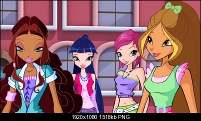

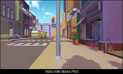

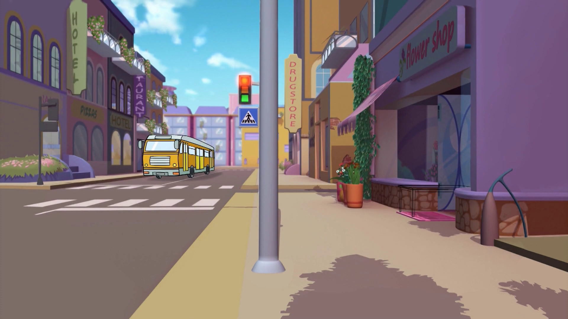

  1. This video has probably been deinterlaced while it actually was progressive, causing aliasing.
    I tried several filters (aaa, daa, maa, aamcsharpmod, eedi2, LSharpAAF), but the 'jaggies' are still there after encoding. Does anyone have a solution?

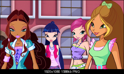

  3. Click image for larger version
    That looks about right, but when using it on another part of the video, the aliasing is still very noticable during movement.

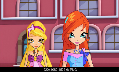

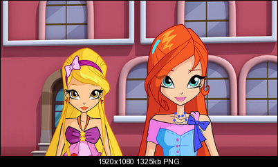

  7. Using Santiag 5 times got rid of it during movement. But as you said, it screwed up other parts of the picture, like causing haloing and some sort of noise in the background (output3a.mkv).

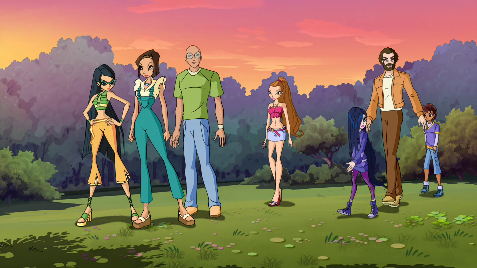

    Before (sample3.mkv):
    After (output3a.mkv):
    I tried a few different variations of this at a whopping 0.45fps, but it didn't fix it. It did bring the bitrate down about 2500kbps (CRF 16)
    MosquitoNR(strength=23)
    Dehalo_alpha()
    LSFMod(defaults="slow", strength=160, edgemaskHQ=true, preblur="FFT3Dfilter(sigma=4,plane=0)")
    Or should I use EdgeCleaner instead of LSF?

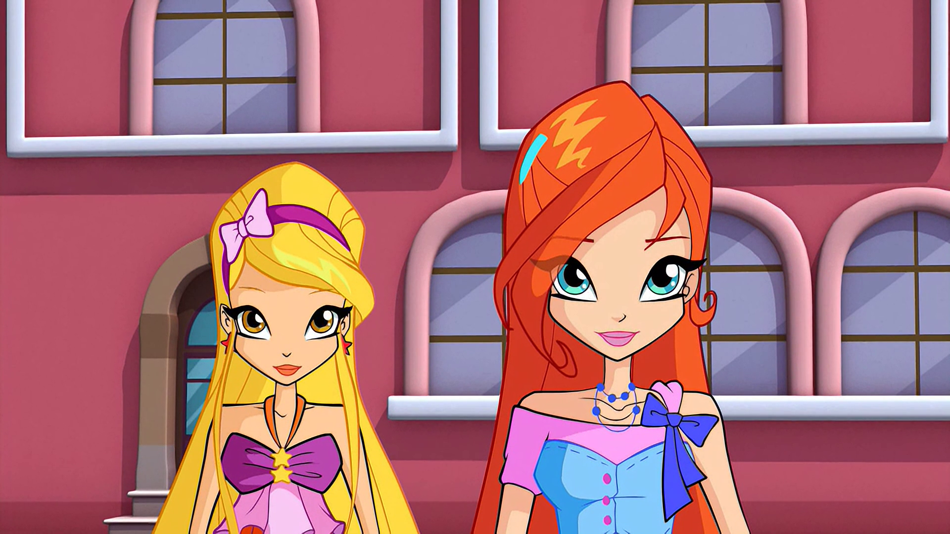

  9. Is there a way to reduce the darkening? It's most noticable in the eyes and around the mouth (it begins to look like a mustache)
    After the last script:
    After the last script with 2 extra Santiags to get rid of noise during movement:

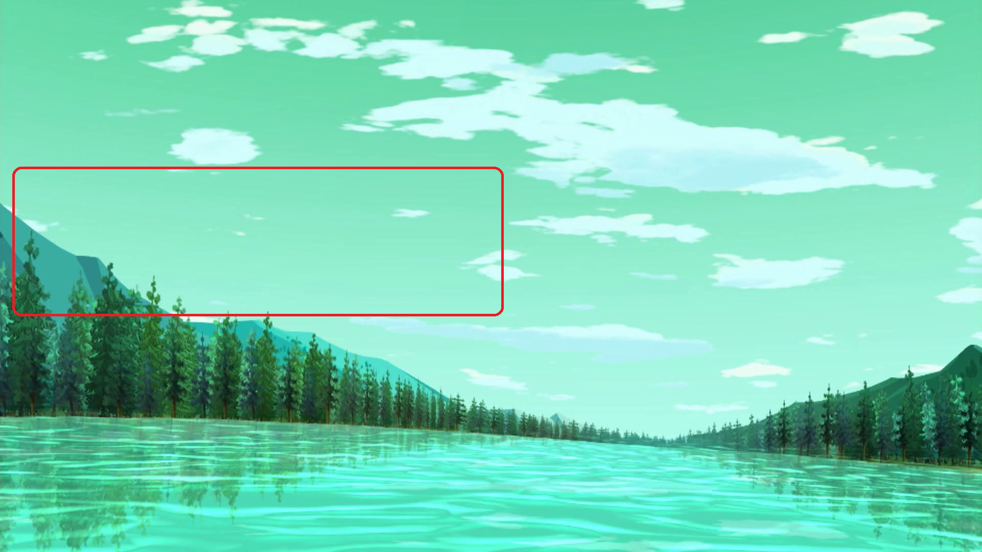

    I also found something else (sample3full.mkv). In the red area, there are a few lines of noise.
    The same type of blocky noise is visible on the face a few seconds later. MosquitoNR didn't get rid of it. Would Cnr2 or a smoother get rid of it? Or do I need to lower my CRF (currently 16 with animation tune)

  10. The slight darkening in areas between two nearby horizontal black lines can be reduced by changing ry=3 to ry=2 in dehalo_alpha(). That should still give adequate halo removal around horizontal lines.
    I haven't looked closely at the other video yet but I think you'll need a debanding filter like GradFun3(). CRF 16 might be high enough quality to keep it from coming back.
  11. That worked
    I tried a few (flash3kyuu_deband, GradFun3) with different settings, but it won't go away. GradFun3(radius=16,smode=2) gives the best result but the flickering is still very noticable
  12. If it's flickering you need a temporal smoother before GradFun3().
  13. That got rid of it, thanks!

    Will using a x64 Avisynth and x264 version speed it up or not? I'm now using 32bit for both.

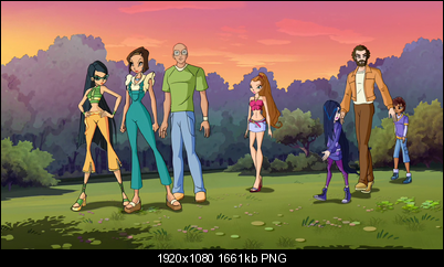

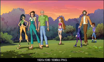

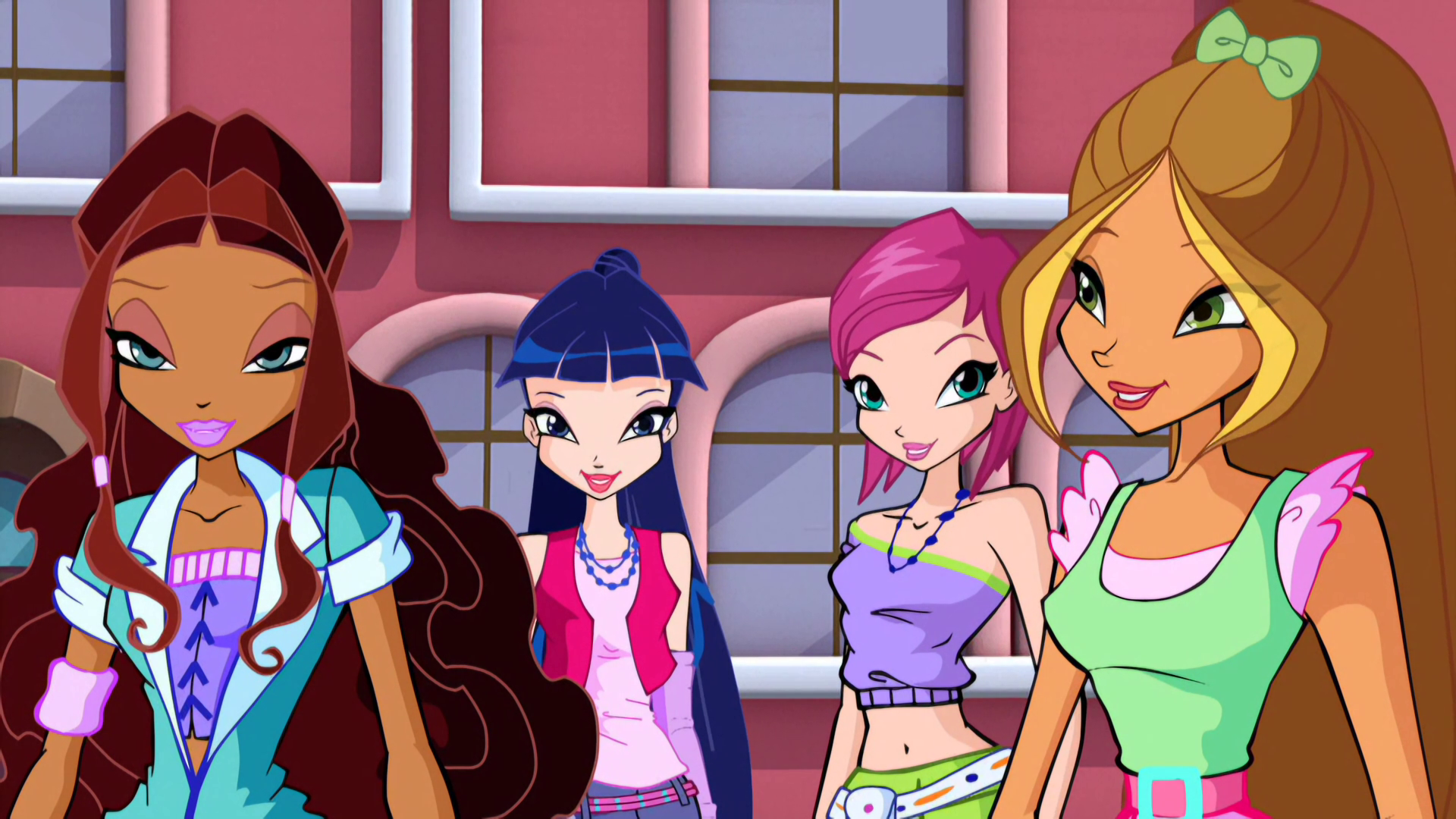

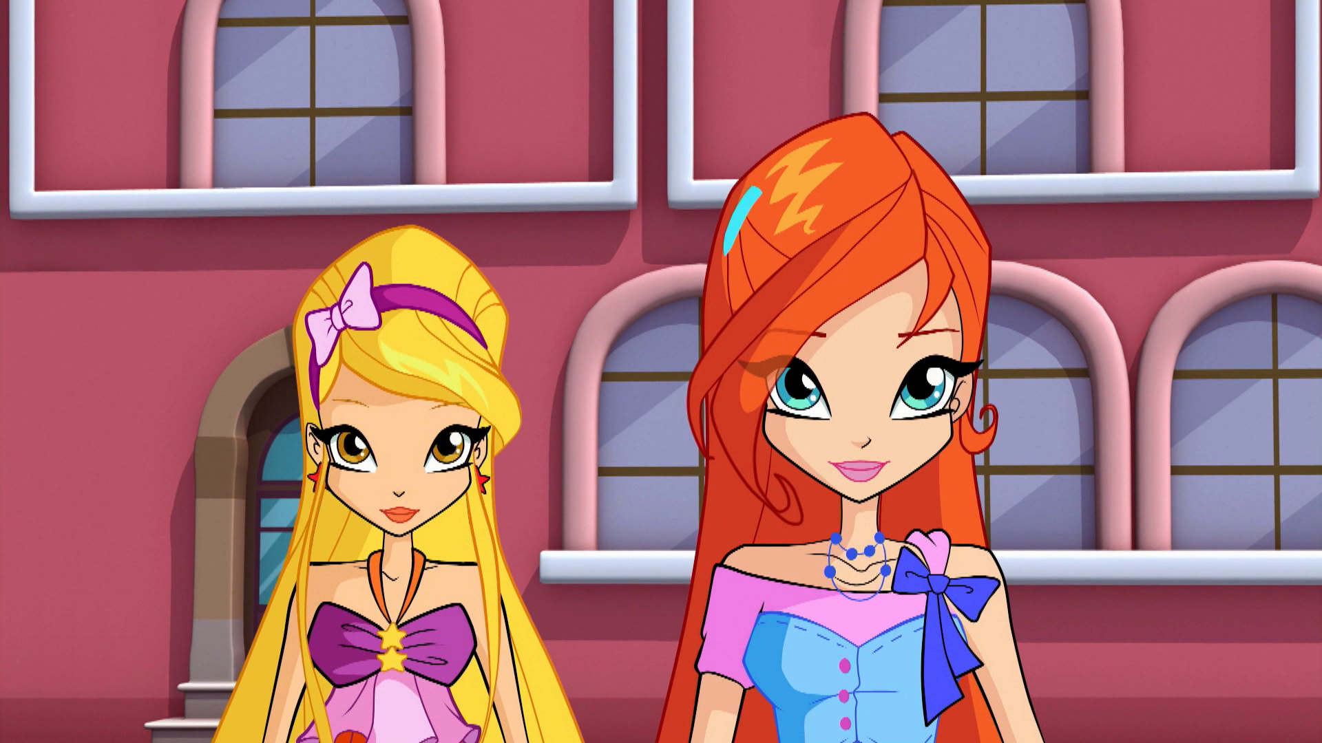

    And will adding a sharpener/Toon make the image look more 'alive'/less dull? (sample25f.mkv)
    Before
    After
    I found another problem in another file. The sample I added (sample.mkv) probably got conversed 25p->29.97i->29.97p. Is it possible to restore it to 25p? I couldn't quite figure out FDecimate.

    Sharpen if you want to. Watch out for over sharpening halos and buzzing edges.
    You can use TDecimate() to return sample.mkv to ~23.976 fps. You won't be able to fix the moire artifacts on the purple stairs but QTGMC(InputType=1, Preset="medium", EZDenoise=2.0) helps a bit with some of the buzzing edges.
  17. Other than the slow speed, it looks perfect
    http://screenshotcomparison.com/comparison/132412
