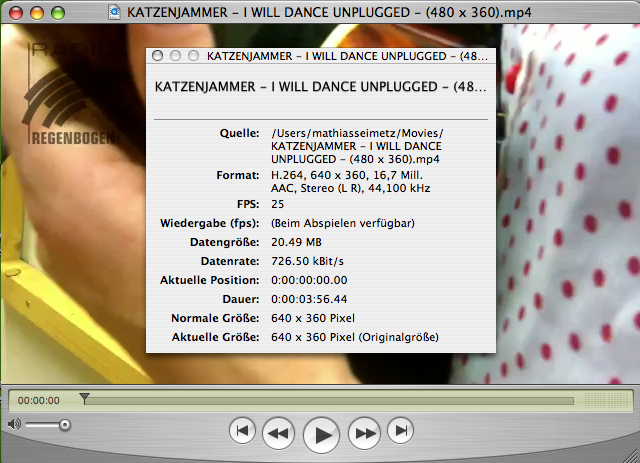

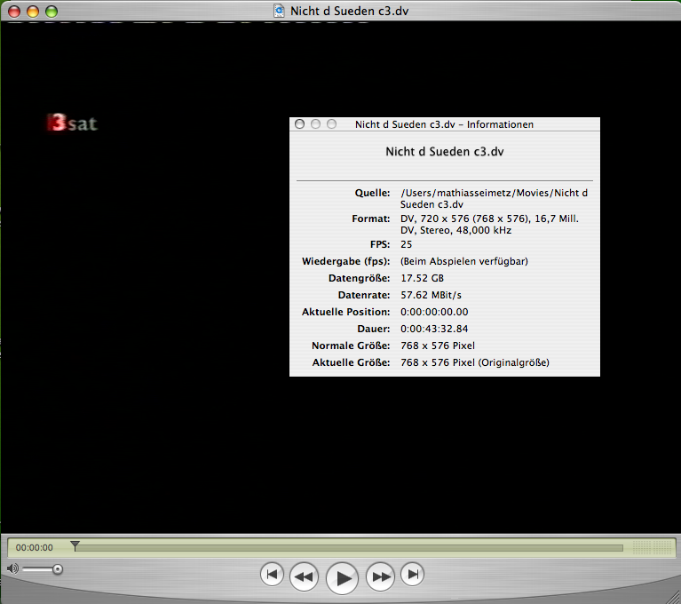

  30. Originally Posted by bilnrobn View Post
    Movingparts, Quicktime will run the full version and the one DB83 and racer-X kindly trimmed, but doesn't indicate the file type, only its size.
    My QT (not a Pro version) does show details like the codec/format.
    Edit: this is version 7 something under Mac OS X 10.4 PPC, the newest version under 10.9 Intel even shows me a tiny bit more detail.
    But it gave me 15mbit/s as data rate for a movie that mediainfo said had 5Mbit/s video and 256Mbit/s audio. This is why people say QT is not always right about the movie infos, because it doesn't analyse the movie but searches for some embedded info or something. I don't know...
