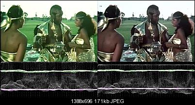

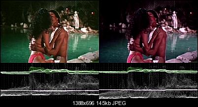

  10. Certainly you can improve specific shots. But different shots require different adjustments. An adjustment that makes some shots look better will make others look worse. For example this rough adjustment
    ColorYUV(off_y=-20)
    darks=ColorYUV(off_u=8, off_v=8, cont_u=-50, cont_v=-50)
    brights=ColorYUV(off_u=14, off_v=6, cont_u=-50, cont_v=-50)
    Overlay(darks, brights, mask=ColorYUV(cont_y=100))
    MergeChroma(aWarpSharp(depth=20))
    ChromaShift(c=-2, l=-2)
    makes this shot better (before on left, after on right):
    but makes this one worse:
    It will take you weeks of hard work to adjust the entire movie shot by shot.

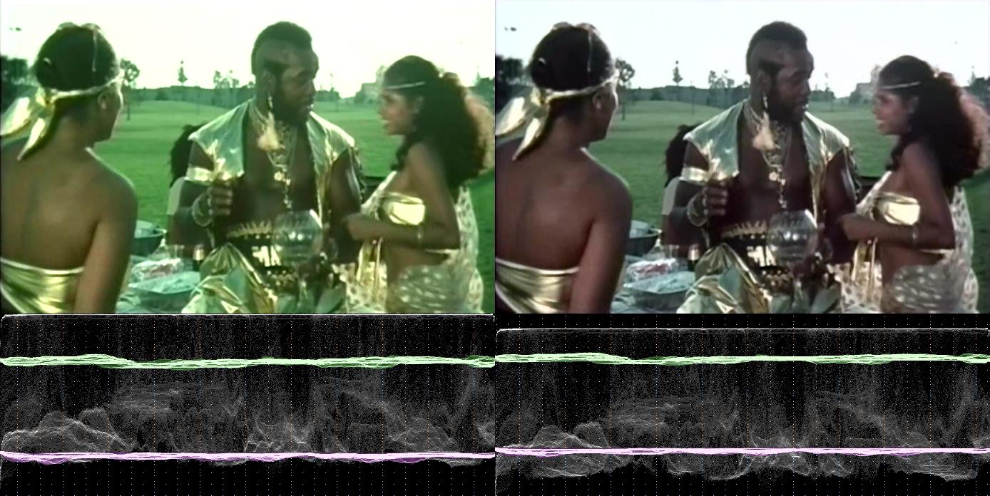

  14. @jagabo
    ColorYUV(off_y=-20)
    [pic]

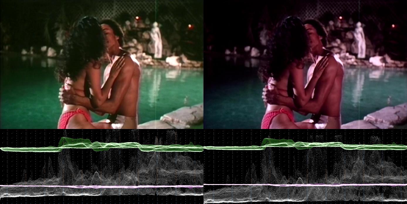

    [pic]
    Thank you very much for this concrete and clear example. It may be “rough” yet is more sophisticated than anything I did before. But it confirms what I already experienced : there might be no “one size fits all” set of parameters that would produce a thoroughly satisfying result for the whole movie. I'm not aiming at perfection though, and sure don't want to spend weeks adjusting this scene by scene. Wouldn't it still be possible to find a good enough compromise, a single set of filters and parameters that would correct the most obvious issues and make the whole thing watchable ? (Like the audio, which was a mess, yet I'm pretty satisfied with what I did -- I spent a whole evening on it though... *sigh*)
