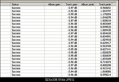

    This is what a foobar2000 ReplayGain scan looks like. The peak values are a percentage so a peak of 0dB would have a value of 1. Anything higher than 1 is potentially clipped on playback, but I think there's generally enough headroom for it not to be an issue. I don't think foobar2000 scans for "true peak" as it requires full decoding and it's therefore much slower, but R128Gain will. I haven't used it much.
    The files below were adjusted to a ReplayGain level of 93dB for a special purpose and a limiter applied if necessary to prevent serious clipping. The ReplayGain standard is 89dB which is why a required reduction of about 4dB is shown for each one after scanning. Every so often there's a peak a little above 1.000000 or 0dB (it depends on the dynamic range and how much work the limiter needed to do etc), but the maximum peak of the third file in the list is the highest at 1.175204 and that means if the playback chain has no headroom at all there's a peak of 1.36dB above 0dB that might be clipped. It's never been something that's made my "things to worry about" list though. Converting percentage to dB is a little tricky but a peak level of 2.00000 would mean a peak of +6dB.
    Foobar2000 can adjust the audio to the specified ReplayGain volume with an option to adjust it without allowing clipping if need be, or MP3Gain has a "maximum no clip gain" adjustment. I think MP3 and AAC audio can only be adjusted losslessly in increments of 1.5dB (up or down).
