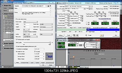

    Total run time 1:55
    Step 1 Render audio as Dolby 5.1 (resulting file is 594,159 kB)
    Step 2 Enter run time, DVD size, audio type into '<b>Marks Bit Rate Calculator</b>' with 5% safety margin
    Step 3 Open Render video template MainConcept > DVD Architect PAL widescreen (no audio)
    Change to VBR 2 pass
    Set Max to 8,128kB Avg to 4,684kB and min to 2,784kB
    Step 4 Render (resulting file is 5,314,832 kB)

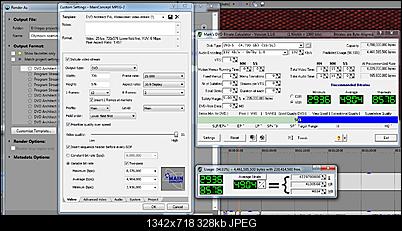

    Step 5 Load files into DVD Architect and I get Red warning that files are a total of 6.3GB and too big.
    What is going wrong ? screen grab below:
Name:	render settings.jpg

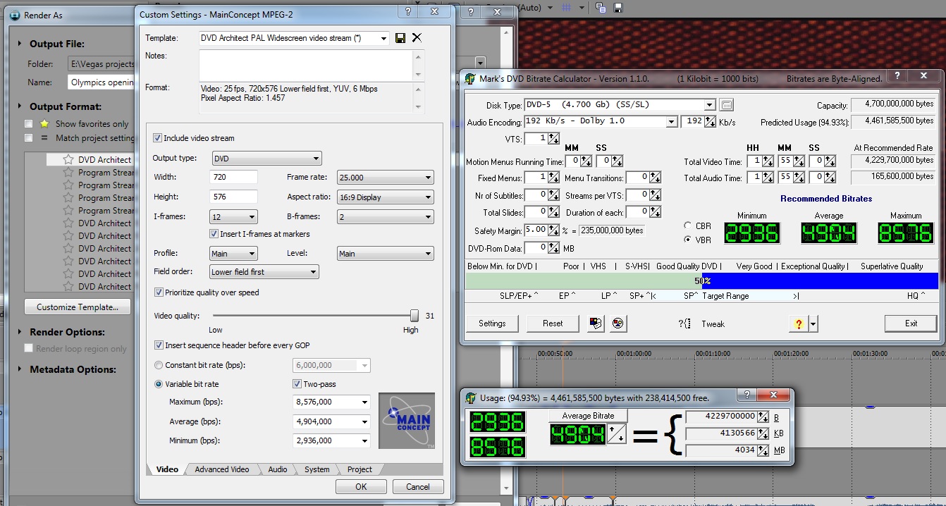

  8. Not sure what you mean by that .... anyway tried again ... this time Rendered Audio out as Dolby 1 (need one copy which does not need 5.1)
    The Bit Rate Calc figures were:
    Max 8576
    Avg 4904
    Min 2936
    Everything else as before ...
    produces Audio file of 254,637kB
    Video file 5,570, 008kB
    still way over what should now fit a type 5 disc ?
    Marks Bit Rate Calculator shows that it should only be using 4,461,585kB
    DVD Architect complains of 131% oversize - and even trying 'fit to disc fails'
    Must be something fundamentally wrong here ? even with no menu overheads etc. .... still way out on calculation

  10. Member Cornucopia's Avatar
    Simple rule of Filesize (overall) = Bitrate (average/overall) * Running time (overall) shows that:
    1hr55min0sec = 6900sec
    4904kb/sec * 6900 sec = 33837600kb = 4229700kB = ~4131MB
    add to that
    192kb/sec * 6900 sec = 1324800kb = 165600kB = ~162MB
    Total = ~4293MB
    If you are getting more with the encoder, you are setting something wrong in the encoder.
    Do you have Audio included in that template (I usually do not, and encode audio in a separate pass, as IIRC the audio options on the MPEG encoder are only MP2) - in which case you might have 1 Audio file and 1 Video (+Audio) file. But that still wouldn't account for everything.
    Make sure you account for x1000 vs. x1024 nomenclature. Capacities & bitrates usually don't match, so you must track the conversion.

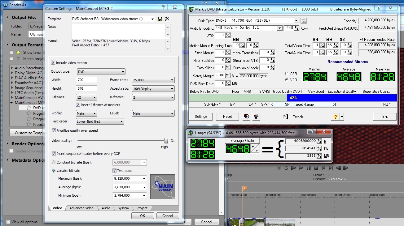

  22. OK ... I found an issue .. (my fault) investigating further - when I looked at Render with MediaInfo it was too long (time wise)
    Traked that down to fact I had a spurious marker out at 3.5 Hrs ... so was rendering 3.5 nor 1.55
    So run it again first off audio is run at Dolby stereo ac3 192 Kb ... gives file of 160,165Kb
    Entered in Marks Bit Rate Calculator
    Selected MainConcept DVD Architect PAL Widescreen
    Set to VBR 2 pass and entered the Calculator settings - (no audio stream)
    Settings are as shown:
Name:	redone with Dolby 1jpg.jpg
    Rendered and results in Video file size 4,347,808 Kb
    Audio + Video = 4,507,973 Kb
    So we are better as no longer ~6Gb ... but when I put these files into DVD Architect, and chose single movie DVD, PAL 16:9 sterepo ac3
    It again gives me an 'oversize error File size of 4.8Gb'
    So back to same issues why does DVD architect claim, this to be oversized ?
    No menus or anything else being added.
    The whole point of using DVD Calculator was to ensure it would fit with 5% safety margin.
