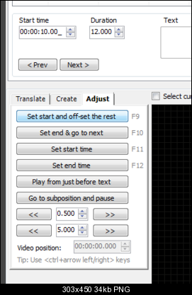

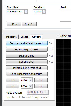

  4. As Johns0 said, lower left corner:

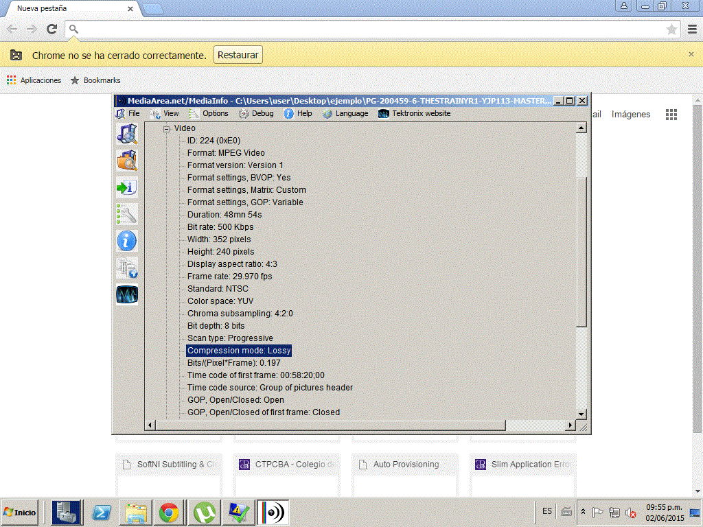

    Im including an example.
    you can see that the video has burned a timecode (starting at 00:58:20.00) and at the bottom right its starting at 00:00:00.00.
    I need the botton right timecode to start at 00:58:20.00)
    canada
    You can't do what you want,if that timecode is burned in then it starts at the time its burned at,subtitle will only adjust text time codes.

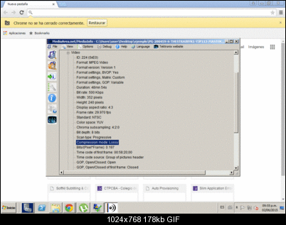

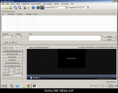

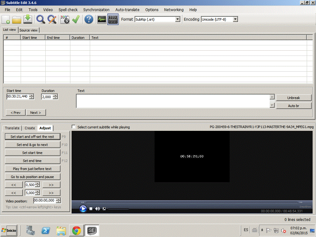

    Jun 2015
    Argentina
    I have checked the video.
    As you can see the timecode of first frame is 00:58:20,00 but in subtitle edit it starts at 00:00:00,0
    Jun 2015
    Argentina
    Please do someone know how to solve this issue with subtitle edit? Thanks very much...

  11. Subtitle Edit does not read timecode. So all files are considered to start at 0.
    The good news is you know the offset: 58;20;00.
    If you're creating new titles, create them to match video, then add a 58;20;00 offset before you export.
    If you're importing existing tiltes, subtract 58;20;00 from the first title start time and slip the rest to match.

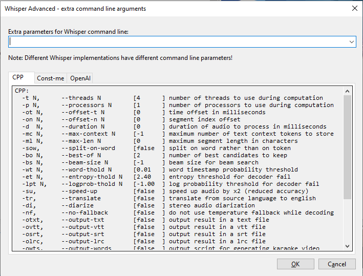

  20. Hey folks!
    I need help in something concerning the Whisper Speech to text function. I use the beta version 3.6.13 because thats what works with hungarian language. So I need help in the usage of the Whisper Advanced command tab, what command should I use to limit the maximum character length Thanks in advanceImage
    [Attachment 72725 - Click to enlarge]
    Mar 2021
    Israel
    You don't need to set a command.
    You have the option:
    Max. Char. per subtitle line > None OR up to 98
    Do you have to use SE?
    CPP is not the most accurate bundle.
    I use the Open AI with command line and I get fantastic results with a GPU of 8GB VRAM
    BTW this is a very old thread. You should have started a new one.
