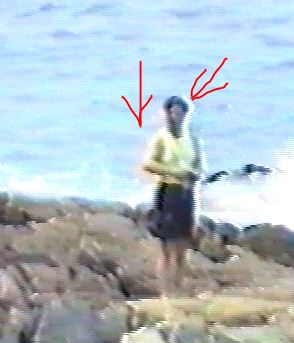

  1. Hi Guys,
    I'm looking for your help as can't find a way to effictevly fix the issues on the video.
    It looks to me as color bleeding and halo effect.
    Sample:

    I've tried to use DeHalo with AviSynth without any good luck
    AVISource("w:\vin\file.avi", true)
    Crop(16, 10, -16, -22)
    yadifmod(order=1, mode=0, edeint=NNEDI2(field=1))
    DeHalo_alpha(rx=3.0, ry=3.0)
    The deinterlacer is used only for test purposes.
    Could you please give me help me how (if possible) could I remove especially this halo effect (on the right side of the guy, looks like extended edge between colors - it is halo)?
    I'm not an expert in video processing.
    Thanks,
    David
  2. It's going to be hard to remove the halos from that n'th generation copy. The chroma is helped by:
    SeparateFields()
    ChromaShift(c=8, l=-4) # shift chroma 8 pixels to the right, 4 up
    MergeChroma(aWarpSharp(depth=20)) # sharpen chroma
    Weave()
  3. Jagabo, thank you for your reply.
    This is the first copy of this tape, just very old.
    What should I use to get rid of these halos if possible at all?
    SeparateFields()
    Weave()
    Thanks.
