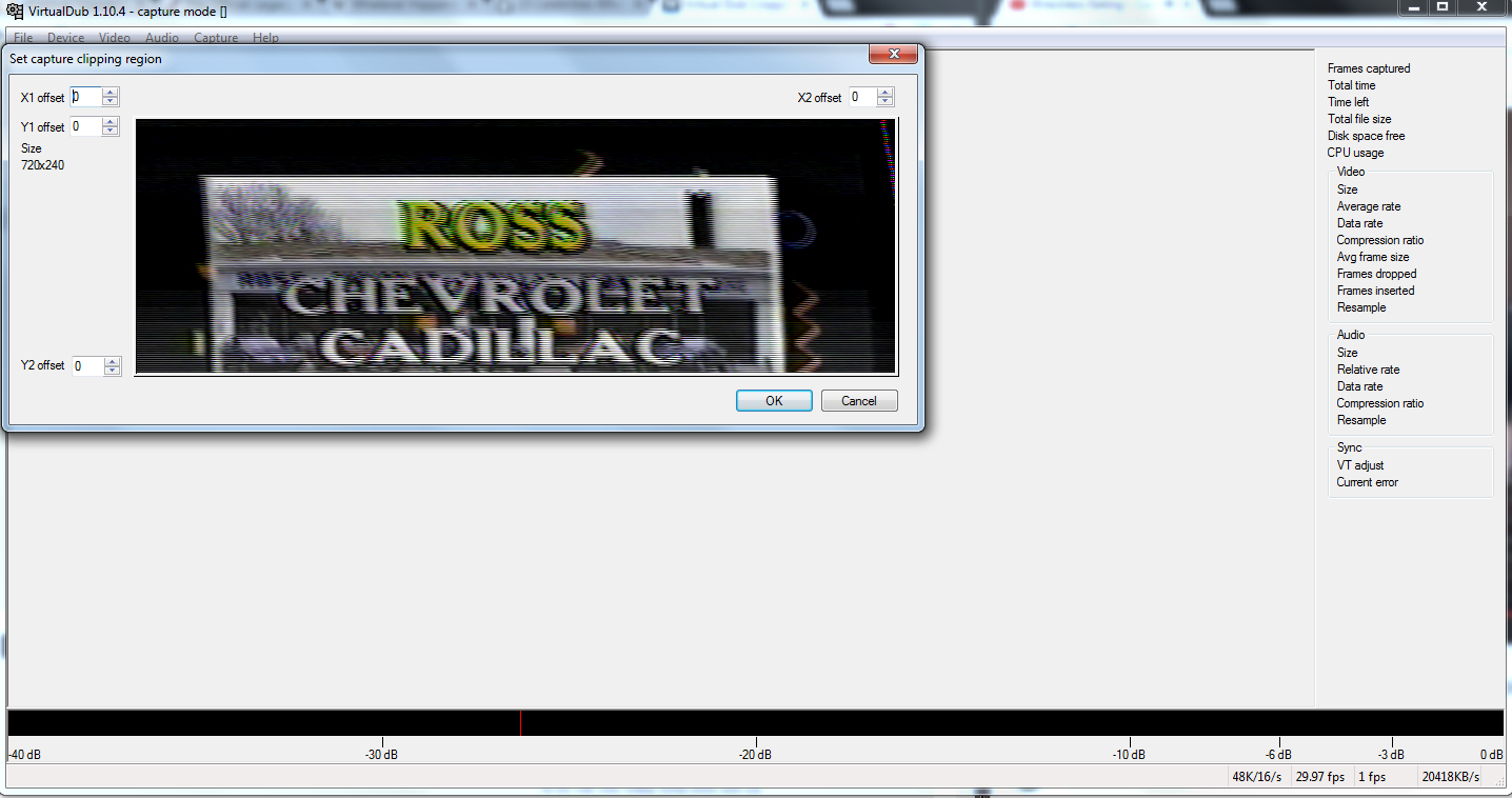

    I decided to try my other computer, since it's specs are much higher, but now when I try and capture VirtualDub crops the footage to 720x240 or 720x288. That, and the issues with the slow/fast audio and desyncing are still present. I have checked every setting I can find on Virtualdub, but to no avail.

    Check your interlacing settings.
    That appears to be a single field capture.

    On the note of the interlacing settings, how do I checks those, as the problem continues even after I remove the deinterlace plugin?
    This is what it always outputs. I can't find anyway to change it.

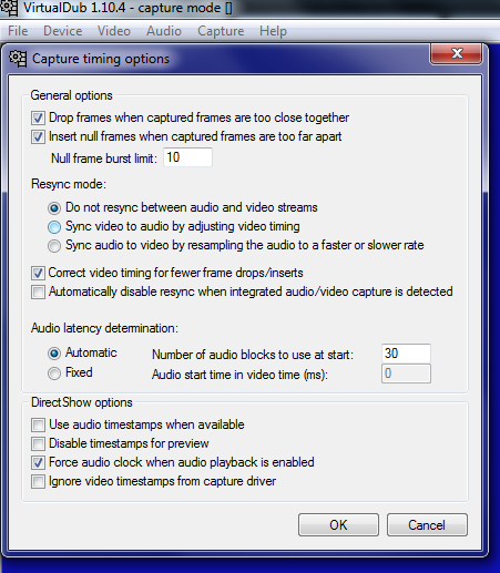

    I would check "Sync video to audio by adjusting video timing" and in editing mode Video->Frame Rate "Change so audio and video durations match".

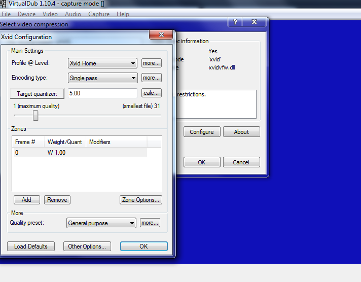

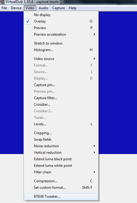

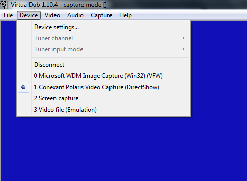

    Here's what I have, everything else is default settings.

    So are you capturing "interlaced" xvid?
    Xvid is already old and crappy, interlaced Xvid is probably worse.
    Avoid xvid.

    Try a different compression. Lossless huffyuv or lagarith atleast.
  10. Look through everything on the Video menu (Capture Pin, Capture Filter, Capture Crossbar, Filter Chain, etc.) and look for interlace and cropping options.
