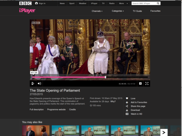

    Probably it's geo-blocked.
    Plays OK here.

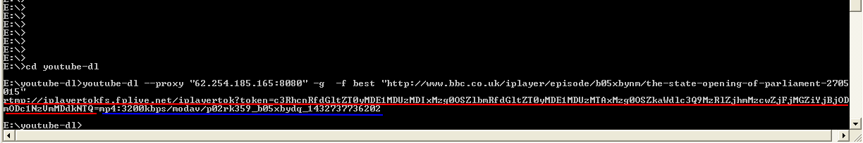

  8. Originally Posted by Joaquim_Link View Post
    Thanks!
    I'm remembering how to use rtmpdump. Was 720p the BBC's HD default option? May you put here how to find the rtmpdump code from BBC iPlayer? Just in case I or another person need it in the future. Thanks!
    Joaquim_Link
    youtube-dl (with proxy to skirt geo-restriction) get the rtmp code
    after the rtmp protocol is not geo-restricted so you can use rtmpdump without proxy
    rtmpdump -r "red" -y "blue"  -o The-State-Opening-of-Parliament-27-05-2015.flv

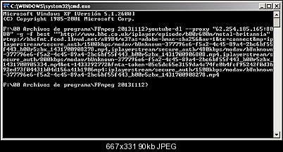

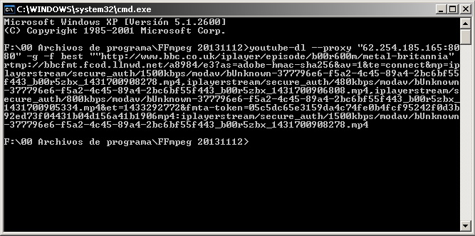

  15. hi!! how i can put this in rtmpdump...???
    "rtmp://bbcfmt.fcod.llnwd.net/a8984/e3?as=adobe-hmac-sha256&av=1&te=connect&mp=iplayerstream/secure_auth/1500kbps/modav/bUnknown-377796e6-f5a2-4c45-89a4-2bc6bf55f443_b00r5zbx_1431700908278.mp4,iplayerstream/secure_auth/480kbps/modav/bUnknown-377796e6-f5a2-4c45-89a4-2bc6bf55f443_b00r5zbx_1431700906808.mp4,iplayerstream/secure_auth/800kbps/modav/bUnknown-377796e6-f5a2-4c45-89a4-2bc6bf55f443_b00r5zbx_1431700905334.mp4&et=1433292772&fmta-token=05c5dc65e3159da4c74fe0b4fcf95242f0d3b92ed73f04431b04d156a41b1906mp4:iplayerstream/secure_auth/1500kbps/modav/bUnknown-377796e6-f5a2-4c45-89a4-2bc6bf55f443_b00r5zbx_1431700908278.mp4"
    i try to download this video
    "http://www.bbc.co.uk/iplayer/episode/b00r600m/metal-britannia"
  16. ...

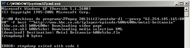

  17. ....I had tried but get the error
    ERROR: rtmpdump exited with code 1

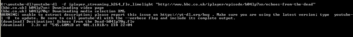

  24. I tried 2 options, it did not work. Can you help, please?
    youtube-dl -f iplayer_streaming_h264_flv_limel
    ight "http://www.bbc.co.uk/iplayer/episode/b04lp7xn/echoes-from-the-dead"
    [bbc.co.uk] b04lp7xn: Downloading video page
    [bbc.co.uk] b04lp70q: Downloading media selection XML
    WARNING: unable to extract description; please report this issue on https://yt-d
    l.org/bug . Make sure you are using the latest version; type youtube-dl -U to
    update. Be sure to call youtube-dl with the --verbose flag and include its compl
    ete output.
    [download] Destination: Echoes from the Dead-b04lp70q.flv
    [rtmpdump] 0 bytes
    I DID HAVE THE latest version OF youtube-dl
    ete output.
    [rtmpdump] 0 bytes
    Or this
    rtmpdump -r "rtmp://bbcfmt.fcod.llnwd.net/" -a
    "a8984/e3?as=adobe-hmac-sha256&av=1&te=connect&mp=iplayerstream/secure_auth/800
    kbps/modav/bUnknown-29049bd4-7ea1-4e19-99cf-b4a1e82149ff_b04lp70q_1433536925107.
    mp4,iplayerstream/secure_auth/1500kbps/modav/bUnknown-29049bd4-7ea1-4e19-99cf-b4
    a1e82149ff_b04lp70q_1433536931838.mp4,iplayerstrea m/secure_auth/480kbps/modav/bU
    nknown-29049bd4-7ea1-4e19-99cf-b4a1e82149ff_b04lp70q_1433536929419.mp4&et=143445
    1878&fmta-token=23c2380c0b98cbc265b88e509c42cc01006fc54b367b fb0c34afa82f85873f79
    " -y "mp4:iplayerstream/secure_auth/800kbps/modav/bUnknown-29049bd4-7ea1-4e19-99
    cf-b4a1e82149ff_b04lp70q_1433536925107.mp4" -o v1.flv
    RTMPDump v2.4 GIT-2013-12-05 (Compiled by KSV)
    (c) 2010 Andrej Stepanchuk, Howard Chu, The Flvstreamer Team; license: GPL
    Connecting ...
    WARNING: HandShake: client signature does not match!
    INFO: Connected...
    ERROR: Closing connection: NetStream.Failed
    because you use RTMPDump v2.4 GIT-2013-12-05 (Compiled by KSV)
    you need use the last version RTMPDump v2.4 GIT-2015-01-15 (Compiled by KSV)
    https://github.com/K-S-V/Scripts/releases/download/v2.4/rtmpdump-2.4.zip
    unzip rtmpdump.exe and librtmp.dll in youtube-dl's folder

  26. Sorry it did not work. Can you help, please?
    With the new version fo rtmpdump I can't connect to RTMP server:
    youtube-dl -f iplayer_streaming_h264_flv_limelight "http://www.bbc
    ete output.
    ERROR: [rtmpdump] Could not connect to RTMP server.

    rtmp://iplayertokfs.fplive.net/ not georestricted
    rtmp://bbcfmt.fcod.llnwd.net/ georestricted need good proxy (often pays) or vpn covering all traffic, not just web browser (often pays)
