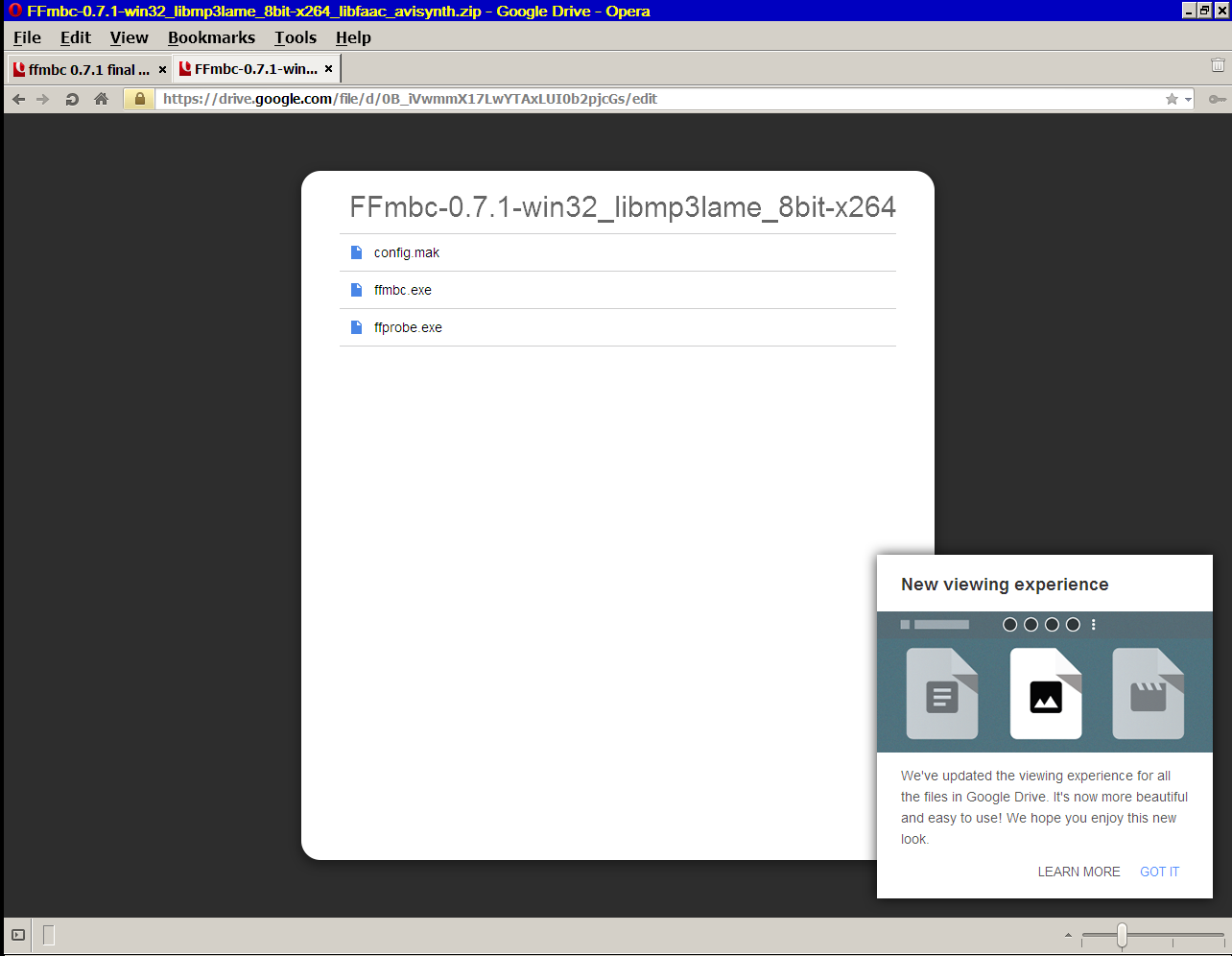

    Originally Posted by MrBiggles View Post
    It's none of those reasons and what's wrong with Google Drive?
    It was designed by and for "excessively-jovial" people
