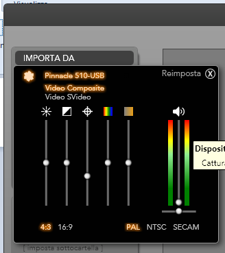

  1. Hi, I'm trying to capture video from VHS with Pinnacle Moviebox hardware and Pinnacle Studio HD 15 software. Tre problem I have is that if I select Pal as video system, the software will not show any preview while capturing, while if I select Ntsc I will see the preview (with inverted lines because my VHS source and VHS player are PAL). I tried to reinstal driver and changing RCA cable, but is always the same.

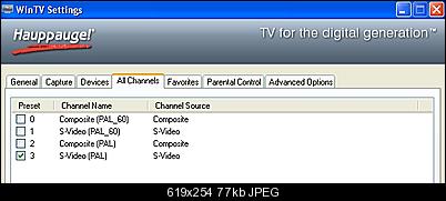

    If it is anything like my WinTV software, you can't just select PAL or NTSC from a drop-down box....you need to go through(although partially) a tuner setup. I have two tuners set up in WinTV, PAL and PAL60(for NTSC tapes through a PAL VHS machine) and I need to switch/disable/enable the correct tuner.

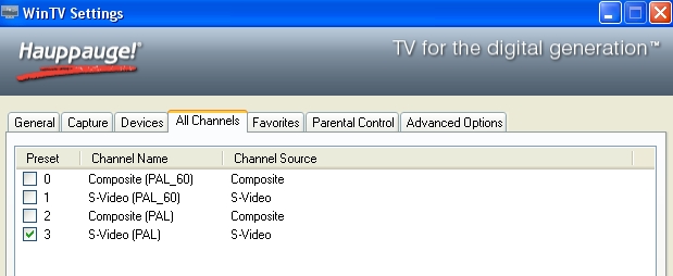

    Tuner Setup.
Name:	tuner setup.jpg
    I know they are different softwares but the TUNER portion is different from the initial setup choice.....usually.

    In Pinnacle Studio I can't find something similar. The only option I have are these:
