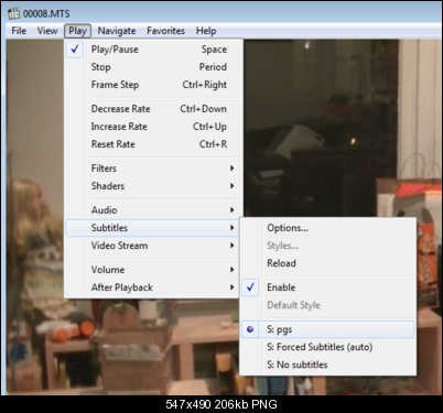

    The simplest solution is to use a player that can display the embedded timestamp (subtitles) in the original files without touching the content at all. MPC-HC works with Sony and JVC files. I assume it will work just as well with canon and panasonic (but I don't have any to test.)
