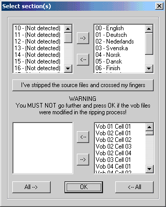

    Start VobSub Configure, press "open" and select the *.ifo file.
    Select an output directory and press OK.
    Select the subtitle streams, that you want to save clicking the and buttons.
    After that press the button.

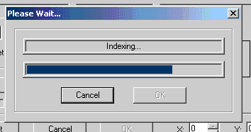

    Vobsub writes a new index now.
    After that the configuration dialog will appear. Select one language[1], select time offset[2] if you need, fade in and out[3] if you like and define the exact position of the subtitles[4]. then press OK.

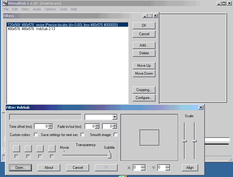

    Let's start VirtualDub, select file > open the video file.

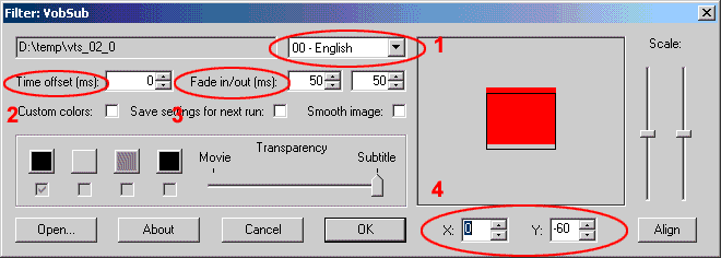

    Select video > filters > add vobsub

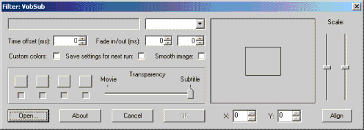

    A configuration dialog will pop up,

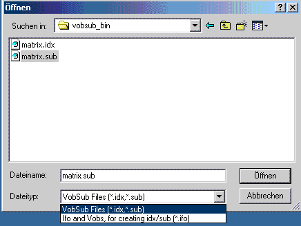

    press open, select the *.sub (.sub and .idx must have the same filename)
    As you can see, you have several options to change the properties of the subtitles, select a language.

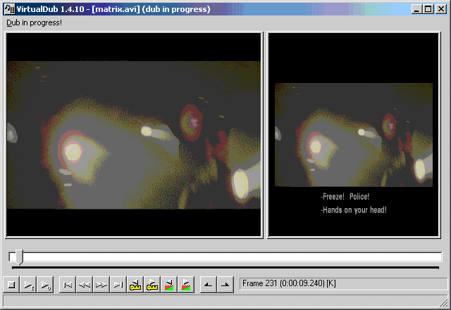

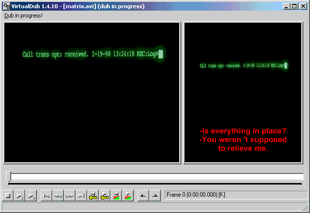

    Close the configuration dialog by pressing OK, then close the VD filter dialog by pressing OK. Now you are back to the main VD window, select file > preview or just hit F5.
    If you want to change position or background color or whatever, abort the preview, select video > filters again. The filter dialog appears, doubleclick on vobsub and you can change whatever you want. Then preview again. If you are happy, select file > Start frameserver.

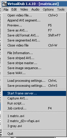

    Frameserve to your favorite MPEG encoder.

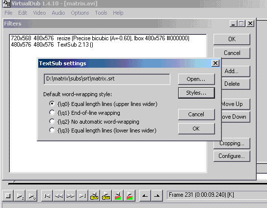

    Scenario 2 --VIRTUAL DUB--
    Your subtitles are ripped by subrip or you wrote your own subs with Sub Station Alpha.
    Select video > filters > add TextSub
    A configuration dialog will pop up, press open, select the *.sub, *.srt or *.ssa

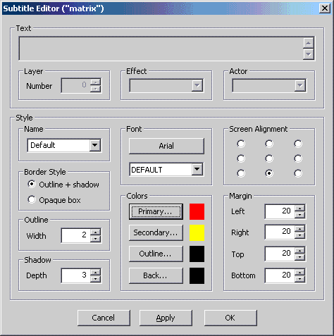

    Press STYLE to open the configuration dialog.
    As you can see, you have several options to change the properties of the subtitles.
    Close the configuration dialog by pressing OK, close the TextSub setting dialog by pressing OK, then close the VD filter dialog by pressing OK. Now you are back to the main VD window, select file > preview or just hit F5.
    If you want to change position or color or whatever, abort the preview, select video > filters again. The filter dialog appears, doubleclick on TextSub and you can change whatever you want. Then preview again. If you are happy, select file > Start frameserver.

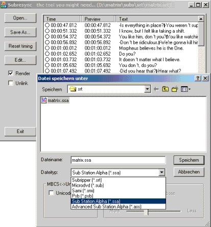

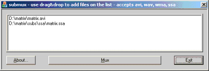

    Go to the VobSub directory and start SubMux. Supported formats are .avi, .wav, .wma and as subtitle file .ssa (SUB Station Alpha). If you have a different subtitle format, you have to convert it to *.ssa.
    Go to the VobSub directory and start SubResync. Open your subtitle file. If the subtitle file is one of the text formats, you can edit it if you like, then save as *.ssa.

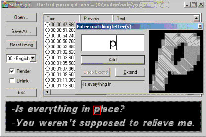

    If the subtitle file is ripped by vobsub (*.sub and *.idx)...
    ... the program has to "learn" which Image represents which character. Answer everyone of these question boxes very carefully. You may know that procedure if you ripped subtitles with SubRip once.
    After that save as *.ssa.
    Finally start SubMux and drag and drop the AVI and the *.ssa into the window.
    Press "MUX" and save as new *.avi.
