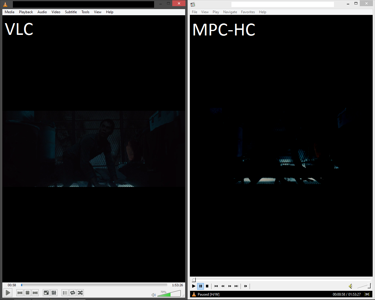

    So as the titles suggests, the video MPC produces is unnaturally dark which is visually unappealing to watch and at times not visible at all. So I downloaded VLC just to see if it was the players fault or somehow my PC, VLC outputs a much better picture or atleast a "normal" render. The MPC image looks completely off and I've tried many things to fix it, there were some people with a similar problem online but not many fixes, I've tried tinkering with the output renderer but the even the ones that fix the problem, create a new problem like not allow subtitles. I have used MPC for a long time now, and is installed on many different PC's at home, but this is the only one so far with this problem.
    If anyone knows the problem, or how to fix it, that would be amazing, since MPC is my preferred media player.
    OS: Windows 8.1 Pro x64
    MPC-HC (64bit) 1.7.8
    I have also taken a screenshot of both video players side by side showing the exact same image on a video which clearly shows how MPC's image is bearly even visible.

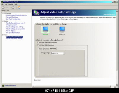

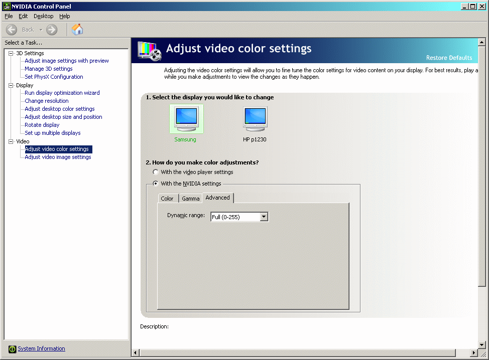

    That's my best guess. I don't know if VLC has an option to expand the levels as I don't use it. I have a Nvidia video card but they all have a control panel and all should have an option for setting video levels. Some expand video levels by default, some don't. Normally if the player is expanding the levels the video won't expand them again so they don't get expanded twice.
    The nvidia control panel looks something like this for setting the video levels,but all vido cards should have something similar. How is the player and/or video card set?

  3. Originally Posted by hello_hello View Post
    Video uses limited range luminance levels whereas PCs use full range luminance levels. In order for video to display correctly on a PC monitor the levels need to be expanded to fill range. If they're not, the picture can look a bit brighter or washed out.
    I suspect the levels are being expanded correctly by MPC-HC but not by VLC and therefore MPC-HC is getting it right but your monitor needs adjusting.
    If you're using the EVR Custom Presenter renderer with MPC-HC (check in it's options) you should be able to right click on the video and select "Renderer Settings/Output Range". If it's not greyed out (only available with some renderers) and it's set to 0-255, it should be correct. If it is, changing it to 15-235 will probably make it look like VLC, but it's technically wrong.
