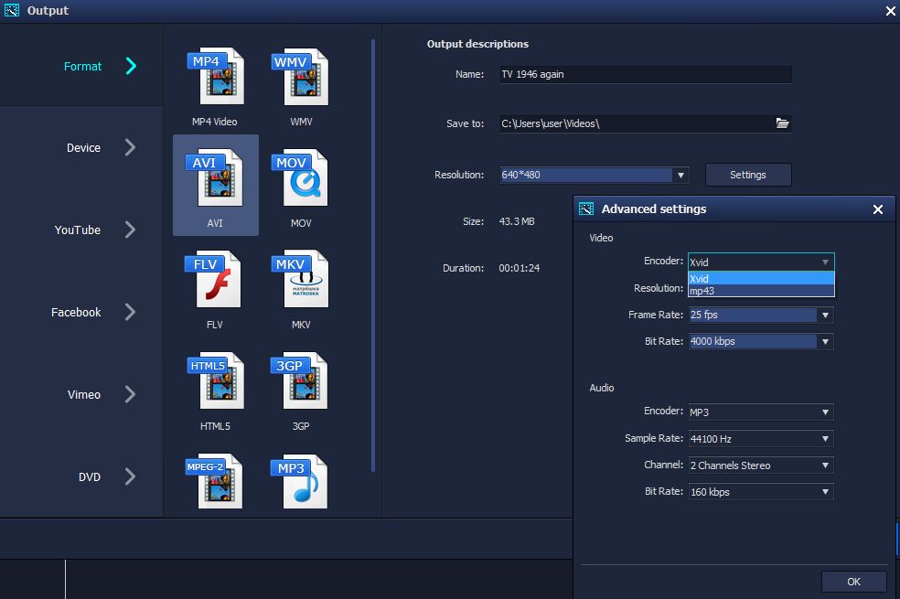

    As to Wondershare can you guide me in the export selections for DV? See attached screenshot.
    Thanks,
    Peter
  13. It's almost certainly an option under AVI and/or MOV. Either would be fine, AVI is more common for PC, MOV for Mac.
    May 2015
    Scotland
    Thanks for all your replies. Wondershare doesn't give DV out but converting it with STOIK video converter and then using WinDV I've now got a working system.
