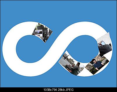

  1. Hi, dear video editing professionals,
    I study Master and we are given a task to create a video about technology enhanced learning environment. At the beginning of my video I would like to combine photos in the symbol of the learning platform of coursera. The similar video I am sharing here is from Goethe Institut: http://www.goethe.de/lrn/prj/wnd/idl/uld/deindex.htm?wt_sc=mwnd_unserleben
    Just in the above example the photos are collected like a maze in a square shape. But I need that they stay one after another in the symbol og Coursera.
    As I am totally new to Video editing, I don't know how to do it. If there is anyone who can help me, I would appreciate it.
    PS: I am using Windows 8.1

  7. ↑attempted like this, looks sucks and troublesome
    Needs a lot of small video blocks in order to fit that curly logo

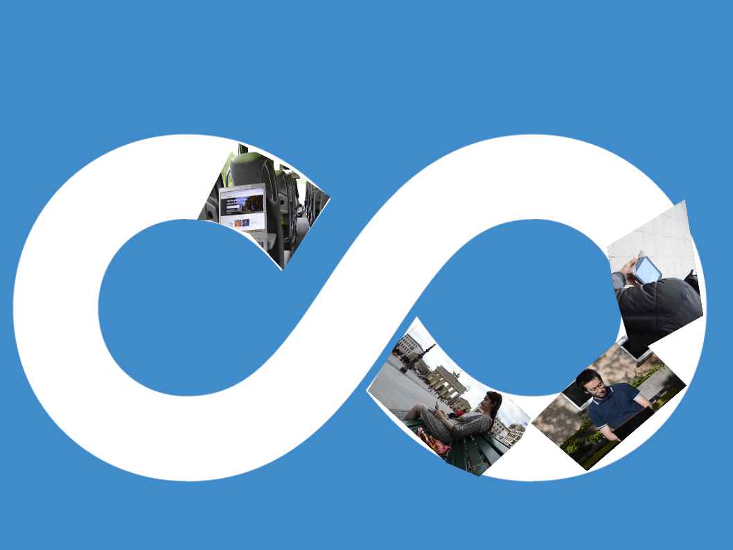

  9. Image
    [Attachment 31857 - Click to enlarge]
    The feathering is going to put you into After Effects territory. That's a lot harder on less expensive NLEs.

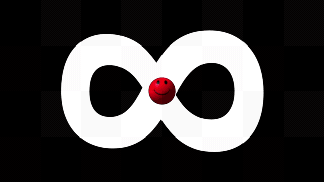

  11. How did you get "follow the path" from the description and example video ?
    The OP can clarify if he's still around - but I'm assuming he just wants a photo mosaic that is regularly spaced as a grid, with some movement in z-axis of individual "photos" on the close up shots as they "fall into place" like the example video in the 1st post . On the last shot, I'm assuming he wants it to show the symbol populated with photos instead of a rectangular grid or square arrangement . (I'm still guessing that it's the "coursera" symbol - he hasn't confirmed)
    Maverick alluded to this, but some photos will be cut off because of the curvature of the symbol - you need to think of an alternate presentation (at least at the end when it's zoomed out) or you have to use a large number of photos on the last zoomed out shot where the entire logo is framed. A large number of photos can pose more challenges, such as more resources required (CPU and memory). One trick that people use for the zoomed out shots are lower res "proxy" pictures to reduce resource requirements, but higher res ones for the close up sequences where you need to see things like face details
