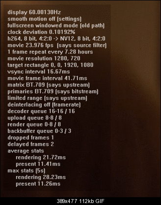

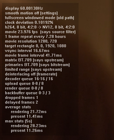

    Anyhow..... if you're using MPC-HC and the MadVR renderer you can press CTRL+J while a video is playing and you'll get something like this:
    It'll tell you the current refresh rate, frame rate, and give you an idea as to the number of frame that need to be dropped or repeated if the two don't match. You need to use CTRL+J while the video is playing, then after it's run for a little bit press CTRL+R to reset the statistics if you want them to be accurate.

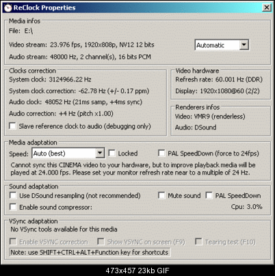

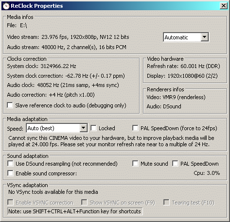

    ReClock might be something to consider if you use a DirectShow media player as it'll automatically adjust the frame rate to match the refresh rate for smoothest playback, so the actual refresh rate doesn't matter so much. It just runs in the background doing it's thing. I live in PAL land so mostly I use Reclock to change the frame rate of 23.976/24fps video to 25fps and leave the TV refreshing at 50Hz. That way, every frame is shown for exactly two screen refreshes and everything is nice and smooth. This might be what it'd tell you though if the refresh rate is 60Hz. Obviously 24 doesn't go into 60 the way 25 does into 50, so that's the reason for using 23.976/24Hz for those frame rates. Assuming your TV/Display gives you those options. I think for notebooks and tablets etc the display is probably fixed at 60Hz.

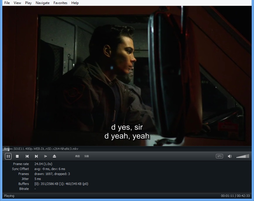

  6. I'm on PAL as well, but i'm not using madVR or ReClock. Any other way to make sure what hertz is being displayed on the TV? Going from the mpc view->Statistics, it doesn show any dropped frames. Except only a few every time the file starts or resumes
    [Attachment 31877 - Click to enlarge]
    Does that show anything? 3 Frames are dropped when file was started, if i pause and resume another 9-10 frames are dropped. While on playback it reports no dropped frames
  7. There's probably other ways but they're the ones I know. I think the EVR renderer tells you if you use CTRL+J. How accurately, I don't know.
    Other than that, try MadVR. It just consists of a bunch of files you put somewhere and then register them so MPC-HC can use it as a renderer. You don't have to keep using it and if you want to get rid of it, I'm pretty sure it's just a matter of unregistering it and deleting the MadVR folder, wherever you put it.

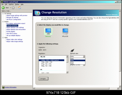

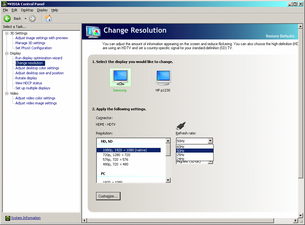

    You should have a list of available refresh rates like this somewhere in your video card's control panel:
